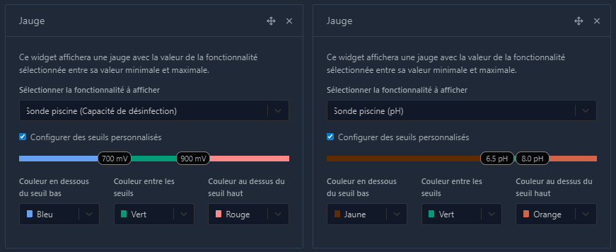

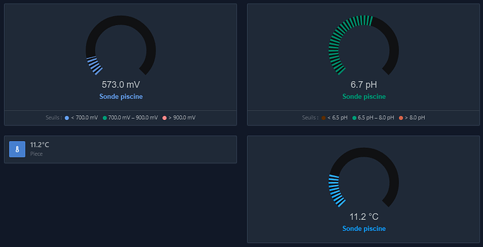

PR 2 — Configurable Gauge with Colored Thresholds
:link: Gauge dashboard widget: add configurable color thresholds by Terdious · Pull Request #2531 · GladysAssistant/Gladys · GitHub
Reuses the threshold + color logic already present in the « Room Temperature Â» and « Room Humidity Â» widgets, but in a generic way on the Gauge widget:
  • Checkbox « Configure custom thresholds Â» in the editor
  • Double slider to define the 2 thresholds (the slider bounds come from the min/max of the feature, so consistent with pH 0-12, ORP 500-1100, battery 0-100, etc.)
  • 3 color selectors (low zone / in range / high zone) with the chart widget palette
  • Legend under the gauge with the 3 colors and the bounds formatted with the unit
  • No custom thresholds → the original ApexCharts gradient is preserved (zero regression)

  • Configurable gauge rather than a dedicated swimming pool widget: generic = useful for many more use cases (electric vehicle battery, soil humidity, dB, tank level, etc.)
  • No hardcoded smart coloring by category (e.g., « pH between 7.0-7.4 = green Â»): left to the user’s choice via the editor, to remain neutral on industry conventions (swimming pool ≠ aquarium ≠ spa)

I tested the plugin generated by the factory on my Matterbridge instance (3.7.9). First assessment :backhand_index_pointing_down:
:white_check_mark: What works well
  • The plugin installs and runs (status Running), connects to the iopool API, discovers my pool, and names it correctly (« Piscine DUBLEM », the name defined in iopool).
  • Water temperature is perfect: reported in a real Matter TemperatureMeasurement cluster → 11.15 °C, natively usable. For this part, the plugin does exactly the job.
:warning: The pH / ORP trap — exactly what we anticipated
Since Matter has no pH or ORP clusters, the AI did its best: it exposes pH and ORP… in TemperatureMeasurement clusters as well. Result:
  • 3 « temperature sensors » for a single pool (water + pH + ORP).
  • pH: the correct figure (6.69) but displayed in °C.
  • ORP: completely wrong — displayed 5.73 instead of 573 mV. The temperature cluster is in hundredths of degrees (Ă·100 on the controller side), and ORP doesn’t fit in this scale → value divided by 100.
