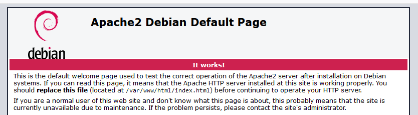

I installed Gladys via Docker.
When I enter my machine’s IP I get this:
Any idea?
:wink:
I’m not really an expert, but maybe you already have a program using port 80 on your machine?
If that’s the case, you can probably change Gladys’s port by replacing it in the command:

In the example I used -e SERVER_PORT=85 \ instead of the default 80.
Then when you want to open the Gladys interface you should enter in your browser: http://your-ip-address:85
OK I’m testing. Thanks
:wink:
With port 85
Result:
