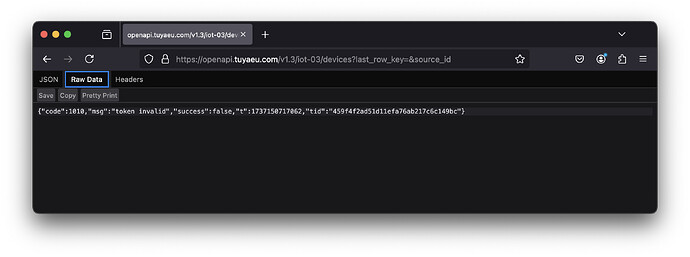

Hi @Xenicle, are you sure you don’t have a network issue or a misconfiguration?
If I open the URL you provided, there is indeed a server at the other end:
(well, a token is missing to test, but the server is definitely there)
