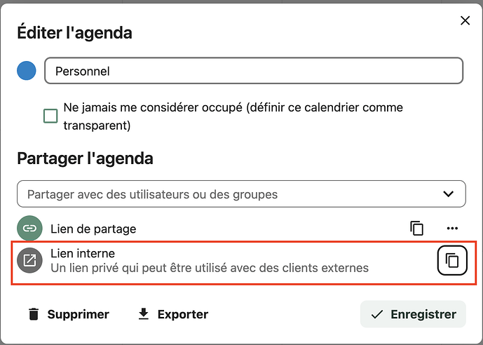

Normally the URL is at the bottom left of the Calendar app in « Calendar settings ». I have the impression that the dialog window you two are talking

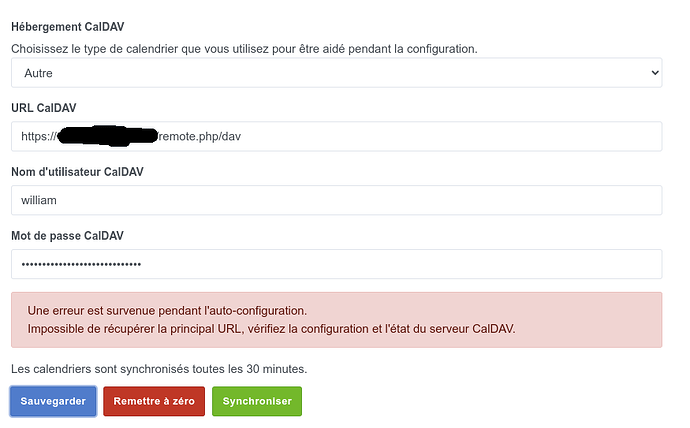

Here’s a screenshot of my config
That seems fine, does synchronization work correctly with your phone or a PC client?
I use the calendar only in Nextcloud on my PC browser.
@bertrandda I just did the test — with the same URL I can successfully synchronize my NextCloud calendar with my phone. So no problem with the URL, it works fine.
But it’s still impossible to sync with Gladys
