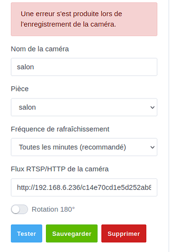

I created the house with the rooms, a dashboard with the weather and two Netatmo cameras
For each camera: the test is OK
however for one of the two, saving fails:
« An error occurred while saving the camera. »
Any idea how to fix this?

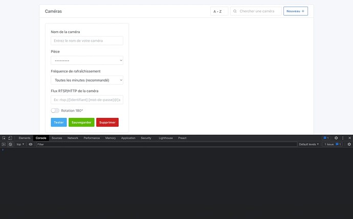

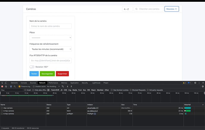

Ok, autre piste, est-ce que tu pourrais ouvrir les logs de ton navigateur quand tu créé la caméra.
Dans ton navigateur, tu fais « Clic droit » sur la page =\u003e « Inspecter l’élément » =\u003e « Console »/« Network », puis tu créé la caméra.
Les deux choses qui nous intéressent c’est les requêtes et potentiels erreurs qu’il pourrait y avoir, comme ça:
(Désolé, c’est un peu tech, mais bon là on a pas le choix pour t’aider :D)

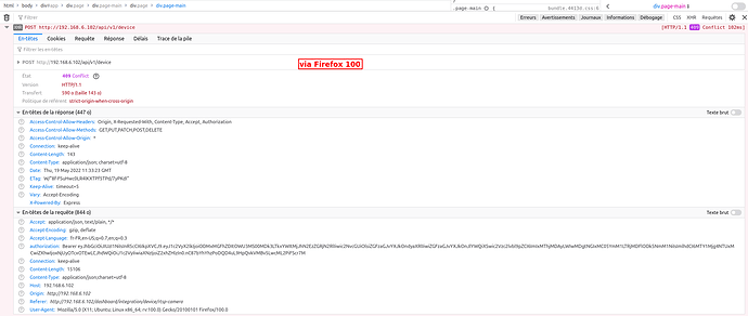

The error occurs when clicking the « save » button.
No error when clicking « Test » which works perfectly and correctly displays the camera image.
Information collected via Firefox and Chromium
Regards
Phil

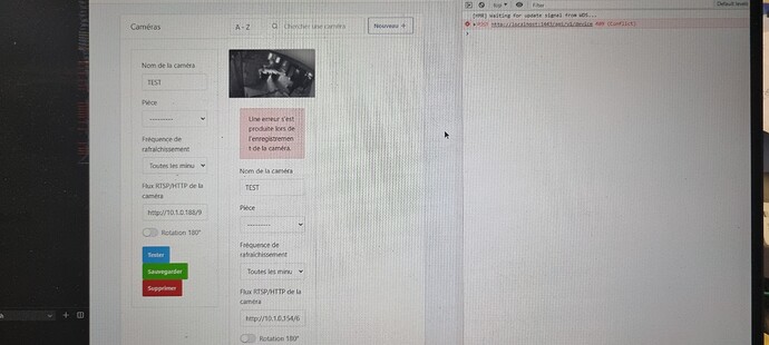

Don’t you already have another device named « salon »?
Have you tried changing the name?
It seems to me that the conflict error corresponds to a uniqueness constraint in the database. Two devices cannot have the same name. Well, in theory. You can bypass this by registering a device for the first time with a unique name, then renaming it. That will work.
If that’s the case, maybe a clearer message should be displayed for the different errors. I’ll open an issue and a PR this weekend to that effect (if you also confirm @pierre-gilles)
Edit : for info I can reproduce it with identical names, also tested with identical names in 2 different integrations!! ^^

There must have been a problem during the additions; however I agree with @Terdious the
100% agree, the message is not at all explicit!
