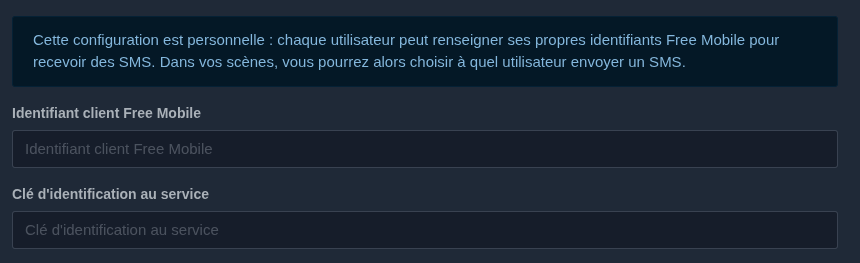

Iâve done a bit of work on it:
Iâll give it a try this weekend and put an image up for testing
Great, now each user can set their own Free API key.
I also added in the user list the option to message everyone
Iâll prepare an image if someone wants to test

Super, a big thank you @Will_71 . I just need to manage to set up a second user
Hi @Jluc !
Each user can have their own Free Mobile key. This wasnât done in the native integration: it displays that it will be removed in a future version.
The replacement is the community integration Free Mobile SMS , in the catalog (notifications category):
Install Free Mobile SMS .
Each person opens this integration, Configuration tab, My Account block, and enters their identifier and Free key.
In the scenes, replace Send an SMS with Send a message , on the Free Mobile SMS channel, targeting the user whose account is filled in.
The old SMS action continues to use the native integration, limited to one key for the whole house. Hence the change of block. Thanks @Will_71 for the integration.
