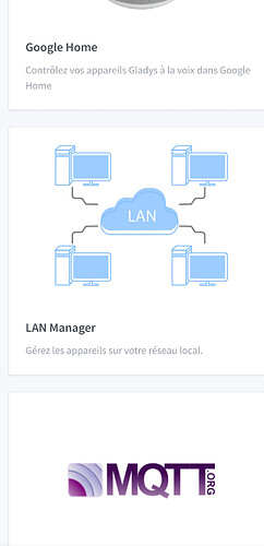

Tested this morning:
  • I don’t really like the logo colors, especially in the services list; it clashes too much with a « default Visio (Microsoft) colors » vibe. The same logo in a darker color would work better, I think (compare with the orange of the Zigbee2MQTT logo or even the illustration for Xiaomi)
