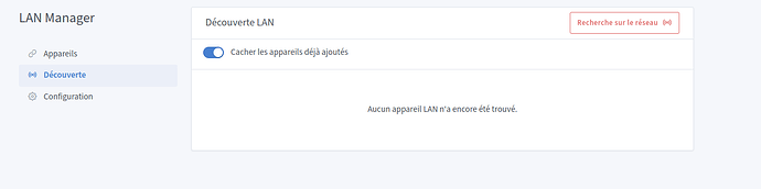

Ah it’s supposed to change color xD?
For me it’s still red :-s
The scan doesn’t stop.

However in Gladys :smiling_face_with_tear:. I restarted Gladys and now it can’t find anything

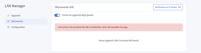

I restarted a second time and I got an error message
In the logs the nmap command, however, seems to have worked

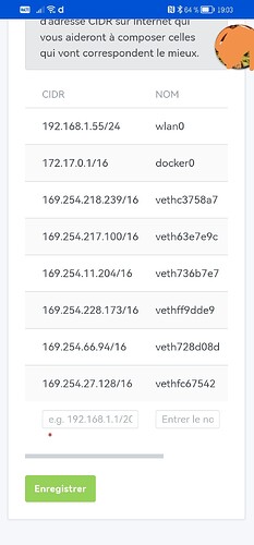

I removed all the addresses except my local one but it doesn’t see anything anymore.

Yesterday, I had three other networks (no idea what they’re doing there).
After disabling them, the service worked.
This afternoon, three additional networks appeared, enabled by default and an endless scan…
And I think the ‹ trash › icon has no effect…

We’ll need to find a way to identify these networks… apparently they are virtual network interfaces…

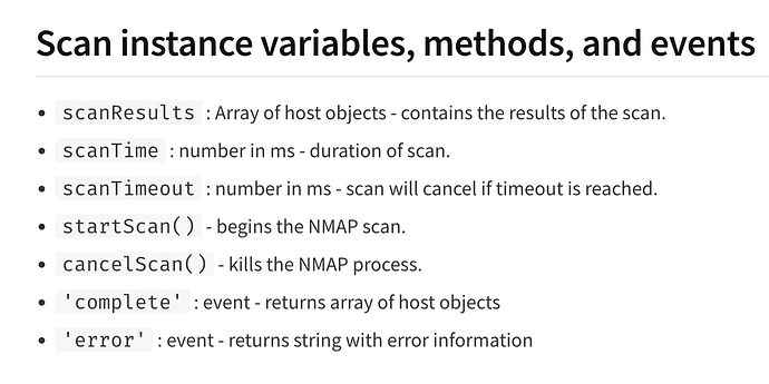

Top! For info the library has a parameter « scanTimeout » so it’s really not hard to set up:

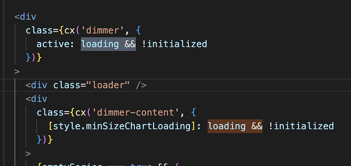

  • Either you put the page in « loading » like we do everywhere with the spinner
I’m talking about this class:
