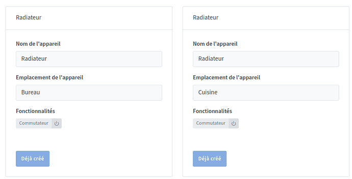

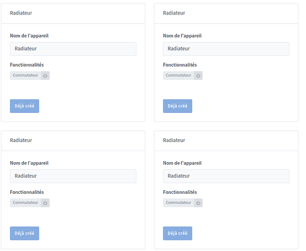

Small bug to report on the Z-Wave integration, I have one Z-Wave device per room to manage each radiator. In zwavejs-ui I therefore declared the name as Radiator and the location as the room.
Except that in Gladys I only have radiators displayed (normal), but it’s hard to know which is which. Maybe add the location somewhere so we can differentiate each device? But I’m afraid that will cause a duplicate with the Gladys room. What do you think @pierre-gilles ?

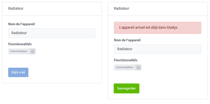

Back to the bug, I get a message when I try to add my radiators to Gladys
There is a conflict with the selector which is not unique.
Looking at the code I didn’t see a selector in the zwavejs-ui integration so I think the selector is formed from the name thanks to this function.
I’m trying to propose something to fix the selector.
EDIT: By adding the selector I can save all my devices
@pierre-gilles, the PR
Well spotted @_Will_71! I left a comment on the PR :slight_smile:
I think we need to do the same work on the feature selector, otherwise it’ll get stuck at that point too, I think
Ok, I’ll take care of it as soon as possible.
@pierre-gilles, I’ve made the changes to the PR.
Thanks @_Will_71! It’s fine with me, it’s merged into master and it will be included in the next Gladys release :slight_smile:

I’m also preparing a PR to integrate the « location » of each device
