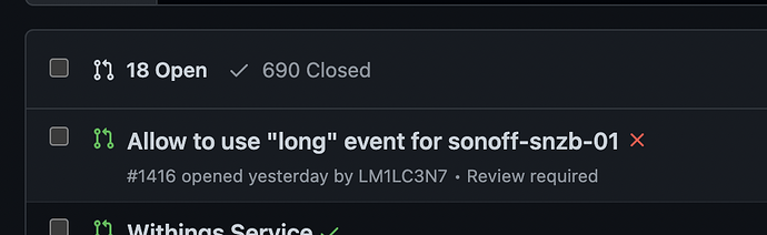

However, for this PR to be integrated, two things are missing:

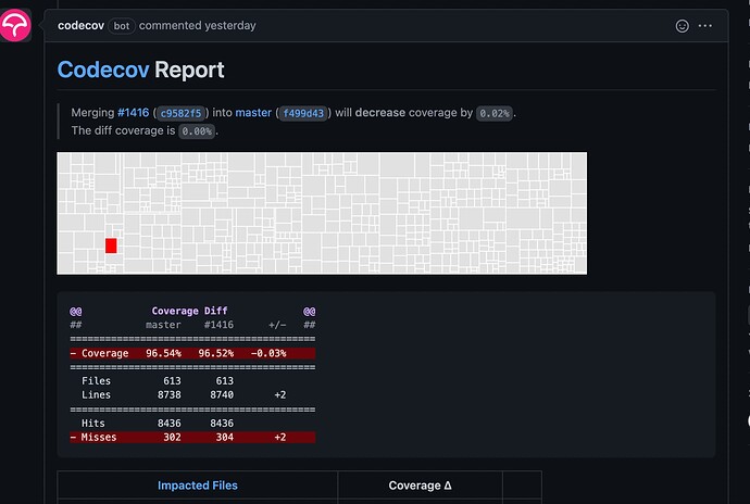

  • Unit tests: Gladys 4 is stable in the long term precisely because we test everything, it’s very important. Your PR doesn’t pass because the code coverage is not good (no tests written).
  • « Real » tests: In Gladys 4, we don’t test in production, we do real tests before merging. To do this, you need to build a Docker build of your branch, which can then be tested by someone who has hardware.

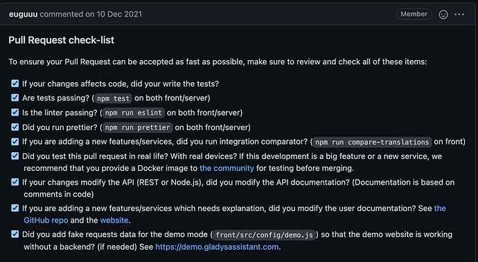

Normally when you create a PR there is a checklist that is pre-filled and must be filled out before merging, I have the impression that you removed it?
Example:
Yes, I confirm, it was indeed present. Given the modification, new tests should not be necessary, can we rely on the current tests?
I made the modification from my work, so from the GitHub web interface and indeed I did not test everything locally. That’s also why I did not leave the list, not having passed all the tests.
Yes but as a result, we don’t have the checklist that allows us to certify that everything is okay with this PR.
No, on this point we are very strict, if there is new code, there must be new tests to verify that the code works and will work in the future.
If you don’t write a test, potentially in 4 months someone removes the line, and it won’t cause any issues since there are no tests, and the one who will notice that it no longer works is the end user.
In Gladys 4 precisely, we are trying to be rigorous, it’s not up to the end user to realize that Gladys is broken with each new version, it’s our processes in place that verify that the software does what we want, now and in the next 10 years :slight_smile:
Moreover, all this is not something I verify, it’s the continuous integration that verifies that each line written is well covered, via our code coverage tool.
Your PR appears as « invalid » and the merge is blocked:
