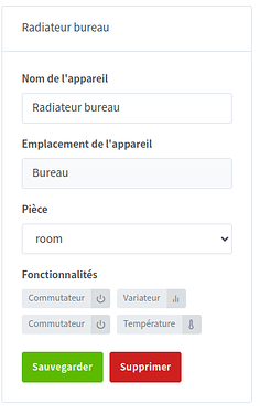

First of all, I do have the new features added to my devices, but if I take the case of my Qubino Flush Pilot device for my radiators I end up with 2 switches.

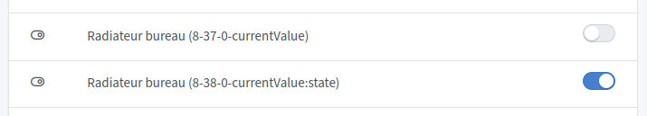

What does the 2nd switch (8-38-0-currentValue:state) represent?
If I look in zwave JS UI 8-38-0-currentValue corresponds to a numeric value for me!

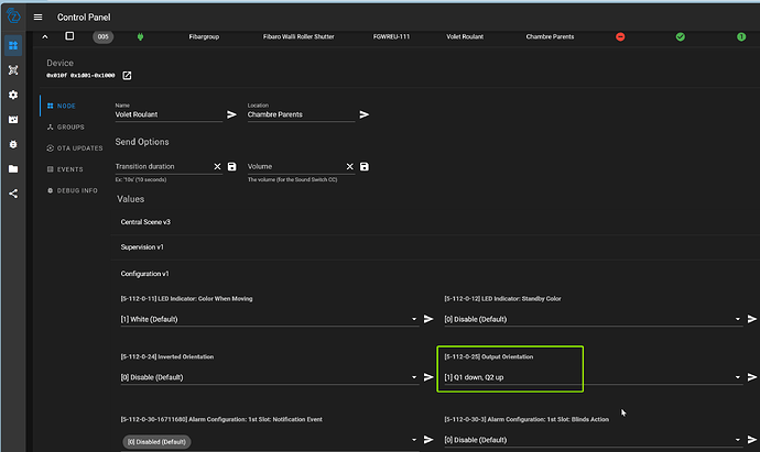

Second point concerns my shutter where I have a Qubino Flush Shutter properly detected in Gladys.
I have the open command that closes my shutter and therefore the close command that opens my shutter. That’s annoying.
So I checked the wiring in case I had reversed the motor. But no, there’s no issue there — it is wired correctly.
The position with the dimmer works fine on both types of devices! :smiley:
Let me know if you need more details about my devices.
Thanks for these tests @_Will_71 !
For the shutter, in my zWaveJs-UI configuration I have this in Output Orientation:
From memory I changed this value because my wiring is reversed. Can you tell me if:
  1. you have access to this config via your device?
  2. its current value?
If you have this config available and its value is Q1 Down - Q2 UP :+1: => I’ll simply invert the states in the code (and either I’ll change my wiring, or I’ll tell zWave to invert, there is an option for that, but that’s my problem :smiley: ).

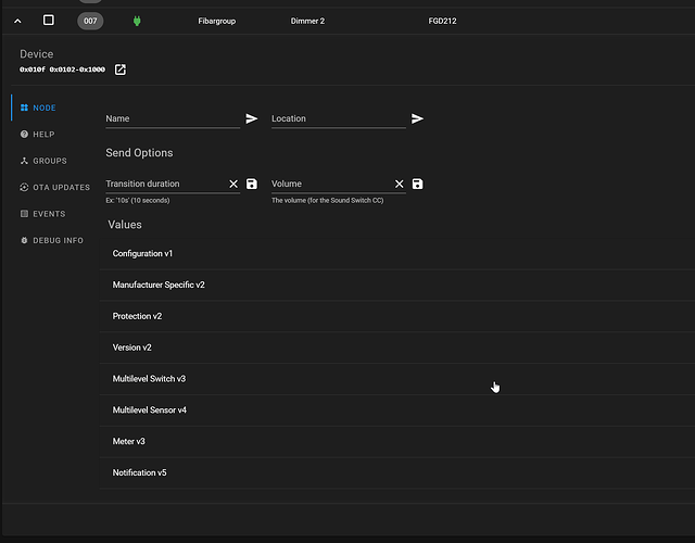

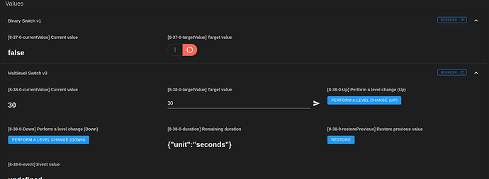

Regarding your radiator’s switch: as you show in your zwaveJS UI screenshot: you indeed have 2 currentValue: one at 8-37-0-currentValue (a binary switch) and one at 8-38-0-currentValue (the multilevel-switch). On my side, the device I’m testing is not in this configuration:
There is no Binary Switch associated with the MultilevelSwitch. One of the differences: you are on V3, I’m on V4. Is that a generality?.. I don’t know, I’m asking you questions further down to act differently…
The question « what does currentValue:state correspond to + the difference with zWave » is therefore legitimate. Gladys’s operating principle is to have a widget for a feature. For the same « zWave value » (8-38-0-currentValue here) if we want 2 different renderings and correct and simple management within Gladys, it is preferable to have 2 distinct features. So we enrich via this PR the fact that a zWave value can correspond to multiple features in Gladys. This is what allows, for example for currentValue, management of several functions: an ON/OFF or a more precise position management. Concretely, an X-38-Y-currentValue in zWave will offer in Gladys 2 features:
  1. a fine position management, identified by currentvalue:position (the dimmer feature in your screenshot)
  2. a global ON/OFF, identified by currentvalue:state (the well-known switch in your screenshot)
This allows you in the interface to choose between a global ON/OFF button or a Slider.
We could probably have gotten away with mapping targetValue. But from a Z-Wave point of view targetValue and currentValue are intimately linked… over the course of development this is the model that emerged. If I’m not mistaken, it’s similar to what the ZigBee integration does in the case of shutters (there is a notion of position and state for the same base functionality).
For a device that does not implement the Binary Switch CommandClass alongside the Multilevel Switch, it seems necessary to provide a quick ON/OFF derived from the Multilevel Switch CommandClass.
With the latest version (I think that between your test and your message there has been a new version of the PR), your device will even offer 3 switches (where the device I’m testing is limited to 2):
  • 1 for 8-37-currentValue: because your device reports a Binary Switch CommandClass
  • 1 for 8-38-currentValue: mapped to 8-38-currentvalue:state on the Gladys side. This is the ON/OFF functionality in Gladys for the Multilevel Switch
  • 1 for 8-38-restorePrevious: which we see in your zWaveJS UI screenshot.
This third switch is the last change of the day. The version you tested assumes that when the user does an ON => we actually ask the device to revert to the last state it had. In the scenario of a switch, if I press turn on => it restores to the same light intensity as the last known positive value (normal behavior of the Multilevel Switch Z-Wave according to the spec and observed on a physical switch). In the case of a radiator, I imagine doing ON restores it « to the last known level ».
But « after all why limit this behavior? Might as well let the user choose ». Thus, we offer 3 features to the user:
  1. 1 slider (currentValue:position);
  2. 1 ON/OFF that returns to the last known position (restorePosition);
  3. 1 ON/OFF that turns on to maximum (currentValue:state).
That thus leaves all possibilities for the user.

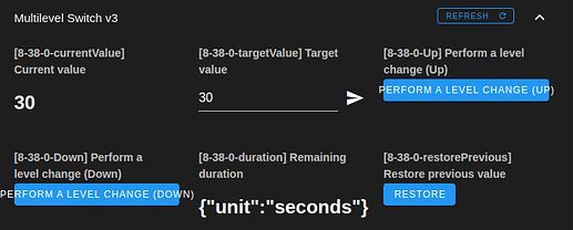

I found another Multilevel Switch at my place in V3:
Unlike @_Will_71’s device, although it’s in V3, this one does not have an associated Binary Switch. So we cannot generalize based on that criterion. Depending on the responses about the behavior of Will’s device requested in my previous post, we will therefore be able to:

For the shutter, I don’t have the parameter to reverse the direction
Regarding the radiator, this device is a bit different because, in reality, I don’t use the binary switches.
It’s the dimmer that controls the radiator.
Actually, the radiator expects 6 different commands to function, and depending on the state of the dimmer, it corresponds to a command.
Here below is the correspondence between the dimmer value and the command sent to the radiator.
Qubino fil pilote:
  • 0-10 : Total stop
  • 11-20 : Frost protection
  • 21-30 : Eco
  • 31-40 : Comfort - 2°C
  • 41-50 : Comfort - 1°C
  • 51-99 : Comfort

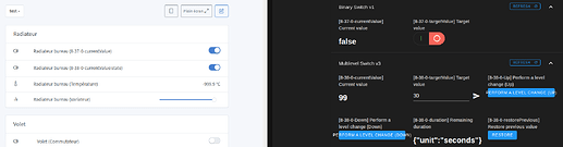

To answer your questions, if I change the state of 8.37, it does indeed change the state of 8.38.
If 8.37 = true, then 8.38 = 99, the maximum value of the dimmer.
And conversely, if 8.37 = false, then 8.38 = 0.
And in all cases, if you change 8.38, it controls my radiator according to the value.
Below are screenshots.
If you want to add switches, I also have 2 others in the Multilevel Switch
And finally here is the DEBUG INFO of the radiator device

Roller Shutter
You have a deviceClass 17-7. This is a device that knows the exact position of the shutter a priori (much better than what I use :smile:!). I don’t know whether that’s related or not. I’ll simply invert the handling of the values in the code. My setup is atypical; I’ll manage (either by reversing the wiring or by asking zWave to invert on its side).

So if I change the binary switch 8.37, it does change the dimmer’s state to the extreme values, i.e. either 0 or 99.
However, if I change the dimmer, it does not change the state of that binary switch.
Regarding the 2nd binary switch, it is true if the dimmer is greater than 0.
As for knowing the value and the mapping, everything is indicated in the device’s documentation. So for me there is no need to translate that in Gladys.
I have the impression that with Z-Wave it’s difficult to define something that is applicable to all manufacturers.
Very clear, thanks.
I see what to change. I’ll let you know this afternoon.
Thanks
@_Will_71 the PR is up to date.
You should now have the following behavior:
  • Have the correct direction for your roller shutters
  • See 3 features for your radiator:
    • 1 dimmer (currentvalue:position)
    • 1 switch (currentvalue:state): it acts as an ON/OFF setting the position to 0 - 99
    • 1 switch (restorePrevious): it acts as an ON/OFF setting the position to 0 when OFF and « last value » when ON
I’ll try :+1:
@Sescandell ,
I just tried. OK for the shutter direction.
The radiator is good too.
But there’s still something bothering me, you can say I’m being annoying :joy:
This concerns the restorePrevious switch you added. First, why put it only for the radiator when it’s also present on the shutter?
And is it really an OFF/ON switch? In the Zwave JS UI interface it doesn’t seem like it.
I understand because the appropriate functionality isn’t present in Gladys yet. It would need to be created.
I’ll explain with an example because the behavior is different between Gladys and Zwave JS UI.
In Zwave JS UI, I have the dimmer at 30.
If I press the RESTORE button, the dimmer goes to the previous value 99.
In Gladys, I also have the dimmer at 30
I press the RESTORE button it switches to FALSE and the dimmer does too.
If I want to go to the previous value I have to press the button again.
I’m not sure everyone will understand to press twice to restore the previous value!
Noting that the switch also returns to TRUE as soon as the dimmer changes state.
