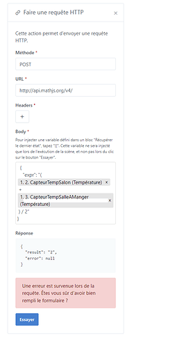

Perform a mathematical operation on a "scene variable"
Exactly, that occurred to me afterwards.
Strangely, the 200 status code is returned but Gladys returns an error (so no variable to reuse).
Ok, actually using braces outside of variables causes the error. I’m updating the GitHub issue.
@lmilcent Actually the error comes from the fact that arrays in the responses were not being handled correctly, the parsing function only handled objects.
I’ve made a PR that fixes the issue:
Do you have a DEV environment to test?

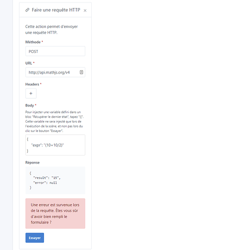

In the meantime, you can use the Math.js API with a simple string instead of an array, and it works well :slight_smile:
What I observed during my tests:
  • First do a test with an expression without variables, like « 10+10 Â» (note: no spaces, Math.js apparently doesn’t like spaces)
  • Press « Try Â», which will populate the dictionary of available variables, because the request doesn’t need dependencies to test the request
  • Then replace the expression with the correct expression you want with the desired variables. Do not press Try, the variables are not available.
  • You can test running the scene with the « Start Â» button at the top of the scene
It works like that for me :slight_smile:
That’s the method I tried afterwards. But on my end, it doesn’t work on the current version of Gladys.
I don’t really
Ah yes, there was another bug actually: attributes that are returned as « null Â» were crashing the variable generation :smiley: So we have to wait for the fix.
Ok, I was talking more about a dev environment (like on your laptop, so you can test PRs)
Well, never mind, I’ll test extensively myself with the Math.js API and it will go into the next Gladys release (not the one you’ll see today)
