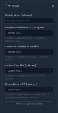

@pierre-gilles Here is currently how it is handled.

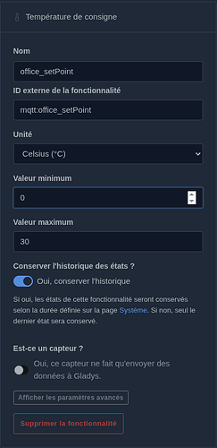

  1. First you must add a device with the Setpoint Temperature functionality in MQTT

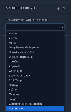

  2. Add the widget to the dashboard
  3. Choose the thermostat device
  4. Choose the device to measure the temperature
  5. Choose the device to measure humidity (optional)
    If not chosen, humidity will not be displayed.
  6. Choose the ON/OFF switch (for now I only have switches but I will add pilot wire modules)

  3. Temperature settings: I retrieve the min, max and unit from the MQTT device

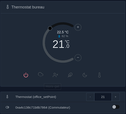

Thermostat OFF

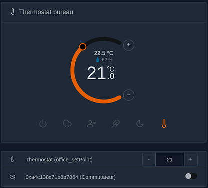

Thermostat in comfort (switch OFF)

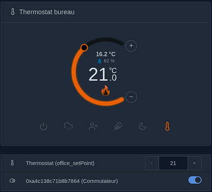

Thermostat in comfort (switch ON)
Today the setting data is linked to the « virtual » device so if a second thermostat is created in another dashboard or by another person the data are synchronized.
As discussed, making it an integration could be simpler for displaying all settings, adding thermostats, creating schedules and sharing with all family members.

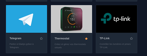

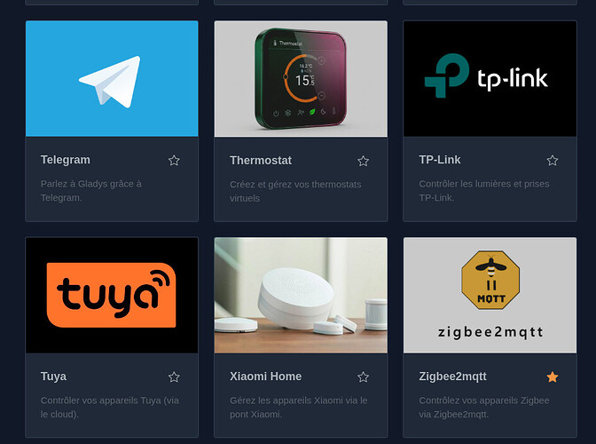

Here is option 1 in the integration selection
Super clean! Good idea to use AI for the thumbnail :slight_smile:
We could take the opportunity, without urgency, to standardize this page, right? I find that the mix of logos/photos/2D/3D isn’t the most aesthetically pleasing…

Maybe we should add « Generic » next to « Thermostat », since the image could suggest that it’s meant for a specific type of thermostat. And why not add a small Gladys logo on the thermostat?
I put it in the text below the title thermostat virtuel; it may not be visible enough.

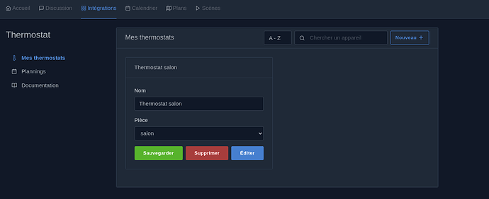

Configuration page where you can create or edit thermostats:

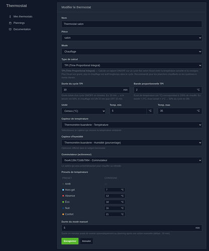

Thermostat settings page (I still have adjustments to make here):
The thermostat device is created automatically without needing to create a virtual MQTT device or anything else. @Terdious you’re going to be pleased

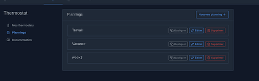

Schedules management page:
Here it’s possible to create new schedules, delete them, duplicate them, or edit them. I plan to add a search and sort bar (A-Z)

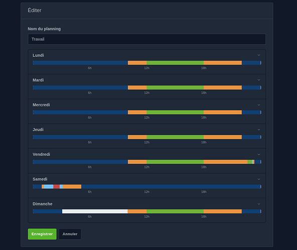

Schedule editing view:

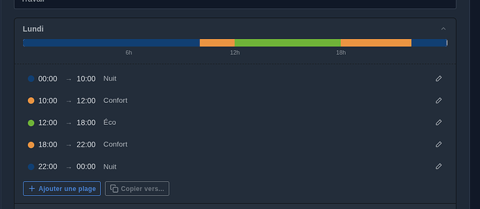

Editing a day of the week:

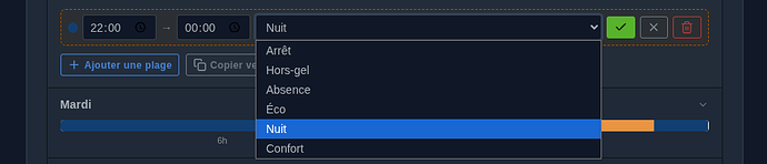

Add / edit a time slot:

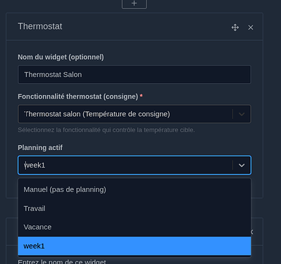

Dashboard edit mode with:
  • Choice of the widget title
  • Choice of the thermostat (created in the thermostat integration)
  • Choice of the schedule: manual mode or schedule mode. Ultimately I’d like the schedule choice to be controllable by scenes.

Instead of « Thermostat feature (setpoint) » I would put « Choice of the thermostat (created in the thermostat integration) » as you indicated above the image — I find that clearer.
