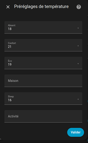

Where you can define which device to control, which temperature sensor to use
Be able to set the low activation threshold and the high deactivation threshold.

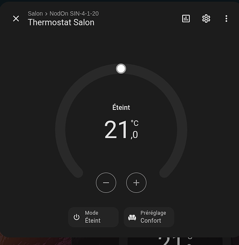

Here are screenshots of an initial preview of the thermostat I made this morning. There’s still a lot of work left…
Mode arrêt:

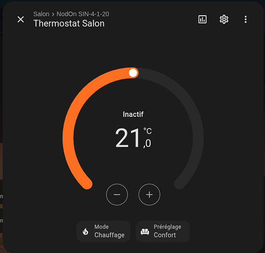

Mode chauffage actif et thermostat inférieur à la température mesurée
Mode chauffage actif et thermostat supérieur à la température mesurée
Pour modifier la consigne c’est possible avec le curseur ou avec les boutons + / -

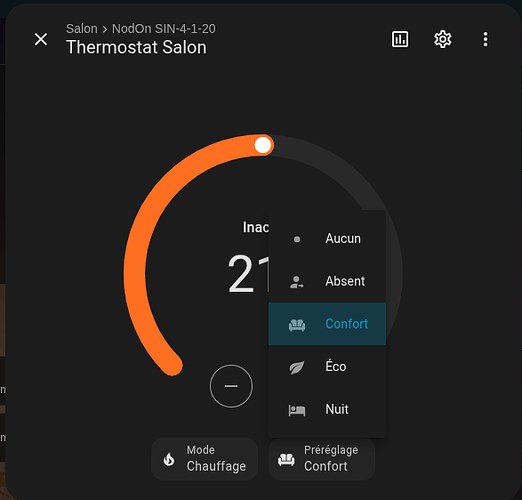

Plusieurs préréglages
Mode climatisation

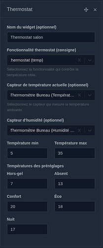

Configuration de la box

Edit menu
Advanced mode settings
With choice of operating mode: Heating or air conditioning
Calculation type: Hysteresis or TPI function

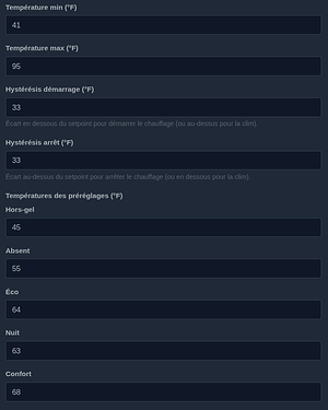

Min and max temperature
Parameters for the calculation type
Temperature presets

  • manage the user parameter for the temperature unit °C / °F

Yes, the setpoint dial is operational, as are the buttons.
Both are possible.
By the settings
I indicated that it’s something I still have to do

The bottom buttons are presets. So if you click on Comfort you’ll apply the comfort temperature; for Eco the preset temperature set for Eco…etc
They’re shortcuts if you prefer.

Quick question @Will_71, where do you put these settings? In the Dashboard?
When you edit your dashboard and apply them to the box.
It’s not global for all the boxes you want to add.
So then, could two users have the same thermostat features with different settings in two dashboards?
Or are features no longer selectable if they’re already in a dashboard?

Currently you can set a different setting per user regardless of the dashboard.
But it’s something that needs to be looked at to avoid conflicts.

The °C / °F conversion is done
