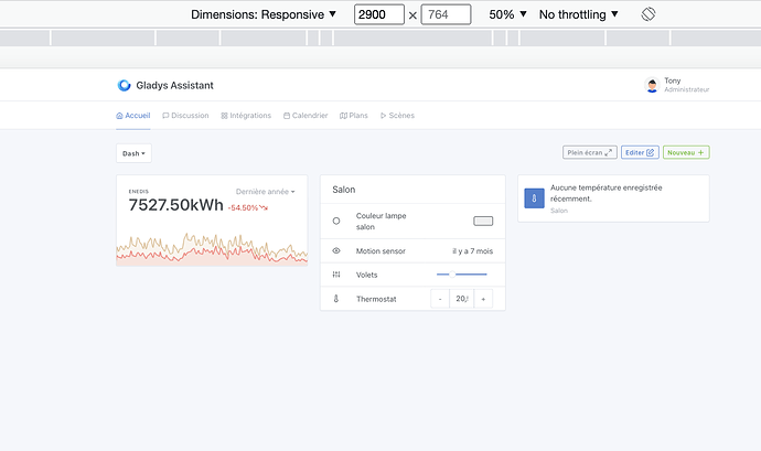

I’m not as enthusiastic as you, I don’t think it looks good in your screenshot, it’s a shame that all the lines are offset while only the thermostat is wide on its right side…

@_Will_71 Actually I’m really not satisfied with the solution I proposed, it’s kind of a hack that only works in your case but for other users it doesn’t work!
For example, someone with a wide screen could still end up with the thermostat « compressed » even though there’s plenty of room:
I think we need to rethink how this box works!
No worries. I agree that if this doesn’t work in all cases, it’s better to review the overall functioning of this box.
