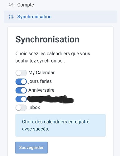

I’m having an issue while syncing Google Calendar.. I haven’t found if anyone has already encountered this problem.
I managed to set everything up thanks to the Gladys doc guide… but when I’m on my Agenda Dashboard, I only see one of my calendars displayed.
However, they are apparently all synchronized and checked:

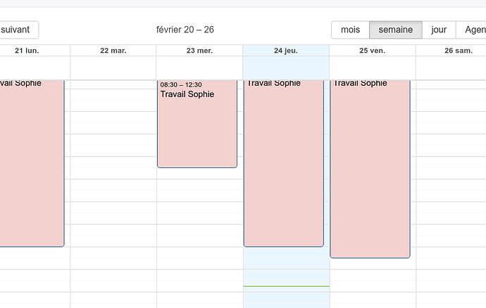

I only have the Sophie schedule displayed on my interface:
I’m having the same issue on my end, only every other calendar is displayed

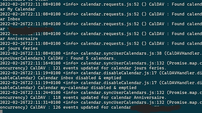

Update:
2022-02-25T10:45:33+0100 <info> calendar.requests.js:52 () CalDAV : Found calendar xxxxxxxx
2022-02-25T10:45:33+0100 <info> calendar.syncUserCalendars.js:38 (CalDAVHandler.syncUserCalendars) CalDAV : Found 5 calendars.
2022-02-25T10:45:33+0100 <error> index.js:52 (Timeout.syncAllUsers [as _onTimeout]) UniqueConstraintError [SequelizeUniqueConstraintError]: Validation error

Database uniqueness issue

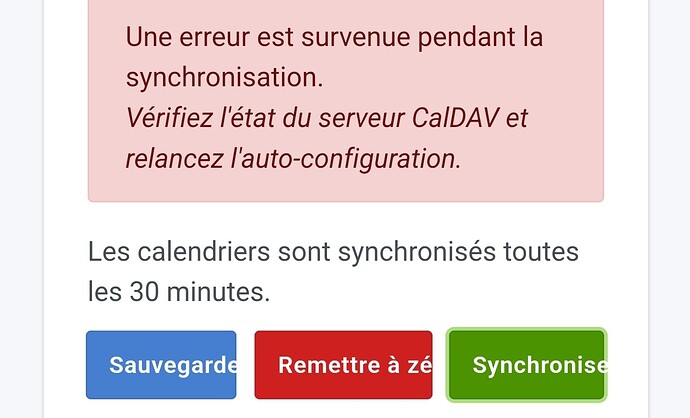

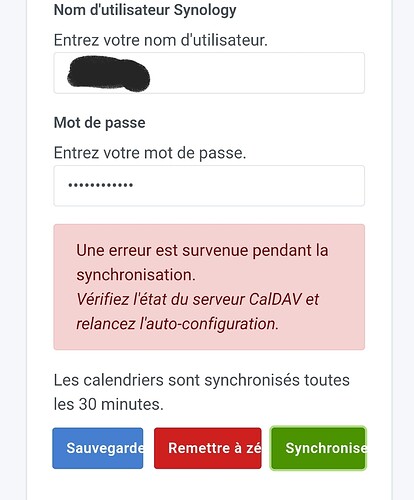

And during the first import, I always have this error that pops up with 0 logs
I reproduce it every time I reset and resync
Any ideas? :frowning:

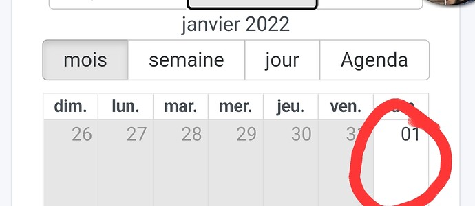

By chance, is it complicated to allow the user to choose the display to start the week on Monday (European style)?
Thanks for the source @spenceur, with that I can try to reproduce and investigate
I think it was the case before, it must be a regression since the transition from moment to dayjs, I’m looking into it as well
For information, I just proposed the fix for displaying the first day of the week (I started with the easiest one)
