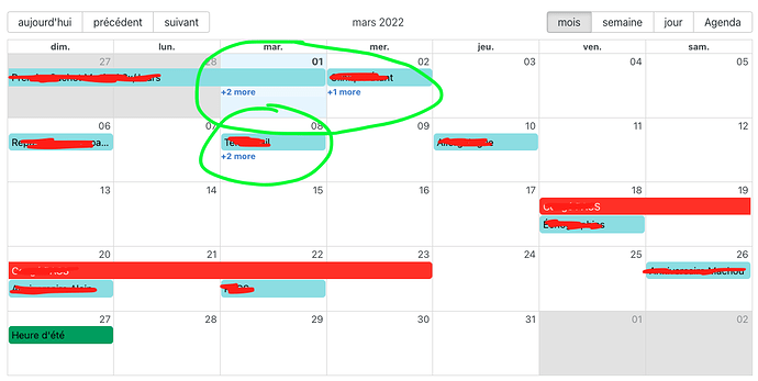

Hello :slight_smile:
I noticed on the calendar display that sometimes it only shows one line even when there are multiple events, and at other times it correctly displays the event without the (+ x more).
I see that this is systematic when there are multiple events from the same calendar or when there is an all-day event and other events on the same day.
Would it be possible to display all appointments when there is enough space (at least 2 easily readable, I would say) even if they come from the same calendar?
Thanks
Hello @Checconio,
I can’t make any promises, but I’ll try to see what can be done. We use a library for calendar rendering (GitHub - jquense/react-big-calendar: gcal/outlook like calendar component · GitHub). It allows us to customize some interface elements (language, date format, etc.), but I’m not sure if the monthly view is very customizable.
In the meantime, while we find a solution, you have the weekly view that normally shows you all the events if that can help you out.
