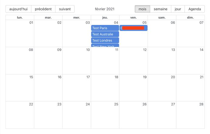

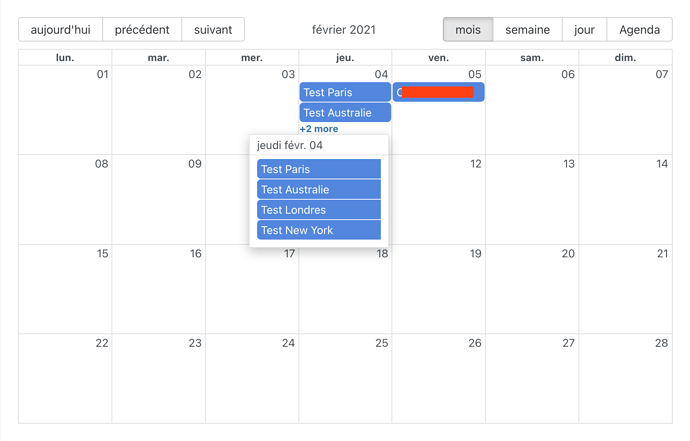

Meanwhile, in the latest version of the component, there are 2 possible alternatives:
The popup version is quite nice I think, do you have a preference while we find a better alternative?
I like the idea of the pop-up too… :slight_smile:
I also confirm that the pop-up version is simple and clear :slight_smile:
The plus that gives a pop-up also seems very nice to me too :wink:
The popup system seems cleaner than the other one

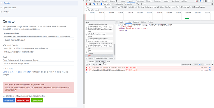

  • I went to the CalDav integration and tried a new synchronization, but there was an error:

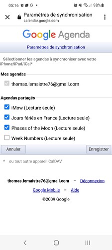

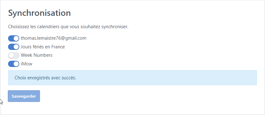

  • I went to the « Synchronization » tab and realized that I no longer have all my calendars, I had three additional calendars before (shared Google calendars and others).
  • I tried unchecking everything and resynchronizing one by one.

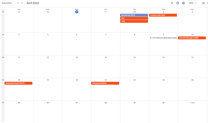

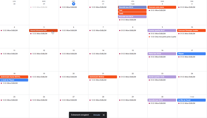

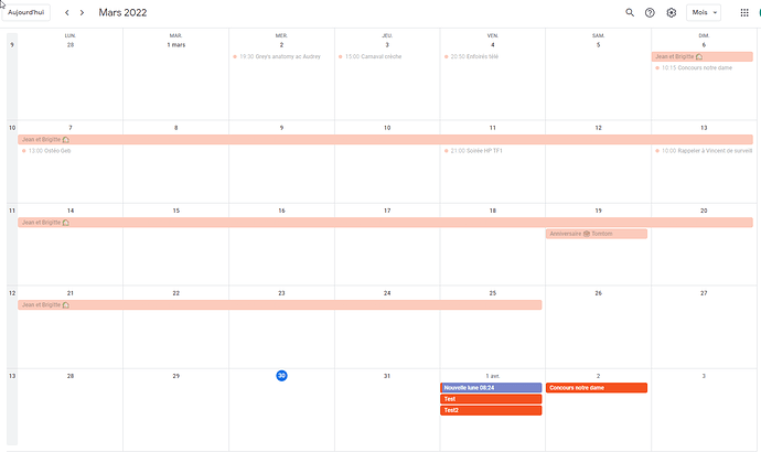

  • The first one (mine) synchronizes, but does not display all events, only some, and I don’t understand why. For example, the « Concours notre dame » appointment was created by my partner’s agenda (shared), which could explain this point, but not the others. I only have a few birthdays, but not others. Moreover, if I create a new event and synchronize, it appears well. However, if I click again on the « Save » button on the configuration page and resynchronize, this newly created event no longer appears. No Docker logs, nothing specific in the Chrome console, and nothing specific in the network requests via inspection:
March and April in Gladys
March and April in Google

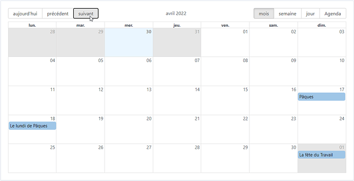

  • The « French Public Holidays » calendar works perfectly.

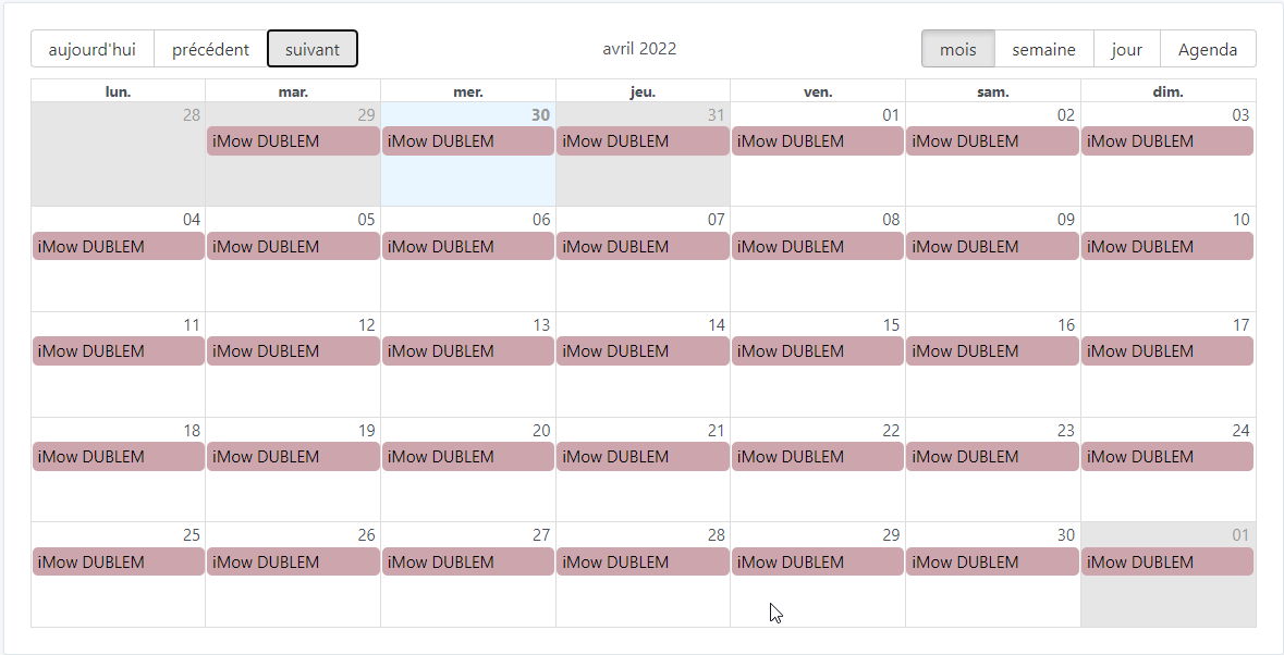

April in Gladys

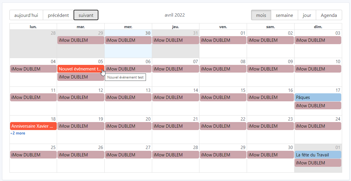

  • The « iMow » calendar works perfectly.
April in Gladys
  • The « Week Numbers » calendar, which used to work, caused a crash. After investigation, I realize that it is no longer visible in the Google calendar (so no way to delete it), and I assume that’s the reason for the crash… but is there a way for it not to appear anymore? ^^ The problem is that if I save the configuration again and resynchronize, all calendars are checked by default.
Error in Gladys
  • The « Moon Phases » calendar, appearing in the same way (and retrieved via Google Calendar via the same tab) as the « French Public Holidays » calendar, does not appear in the « Synchronization » tab.
Synchronization in Gladys

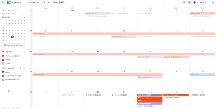

March and calendars in Google

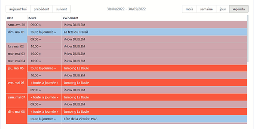

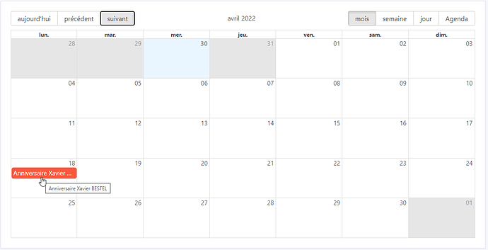

Otherwise, once the « Week Numbers » calendar is deactivated, it works almost fine except for my main agenda, where only the newly created events appear along with a few birthdays:
April in Gladys with new test event
April in Google with new test event

So the issue is indeed resolved for the main calendar!! Good job @bertrandda :wink:

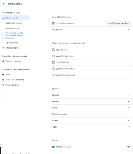

How did you create this « Moon Phases » calendar in Google Calendar? Is it an import?
In the same way as the « French Public Holidays » via the menu « Other Calendars + » / « Browse Calendars That May Interest You » / « Local Public Holidays » for the first and « Others » for the second:
