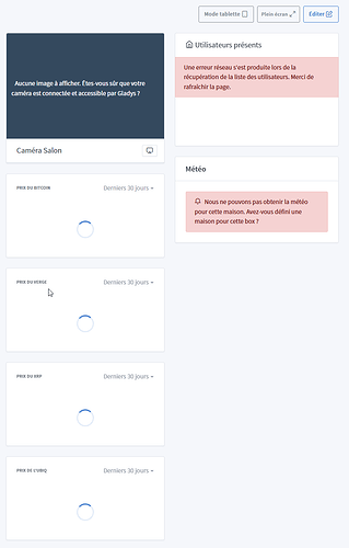

The migration is finished on my Pi. Migration, purge and cleanup OK. BUT now, a lot of stuff is messed up.
Sometimes I log in and it tells me that my dashboard is not configured then after a few refreshes I get my dashboards back. But the display of present users, the weather and my crypto graphs coming from Node-RED do not appear.

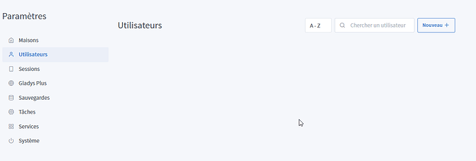

If I connect via Gladys Plus, 1x/2, it tells me that it is not connected to the gateway and there are no users to select. Same thing from the Android App
In the settings, the pages are empty. I have to refresh many times and at some point I recover the data.
Many scenes simply no longer run.
I should clarify that this happens on Brave, Chrome and Edge.
It’s a complete mess, I think I’ll reinstall Gladys completely on my Pi. :smiling_face_with_tear:
Are you sure the purge is finished? It can take hours, even days during which Gladys is a bit out of it (especially on RPi)!
Have you restarted the container (or the RPi)?
Please note that the accuracy of the number of states in SQLite on the System view is not real. It may show « 0 » even though the purge has not finished. Do not hesitate to rerun if needed (it will become faster and faster and be almost instantaneous when it is actually finished), then run another cleanup afterwards.
