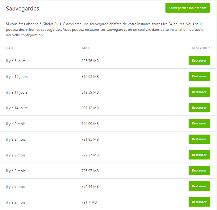

Well, I’m sorry, I’m back with « bad » news, the performance issues are still present and still with the same cause: resources taken by the database backup. This still results in a loss of access to Gladys for 4/5 minutes every 30 minutes, very random Gladys Plus backups, and permanent errors on aggregation. This has been bugging for about 2 months again (backup going beyond 750MB?)

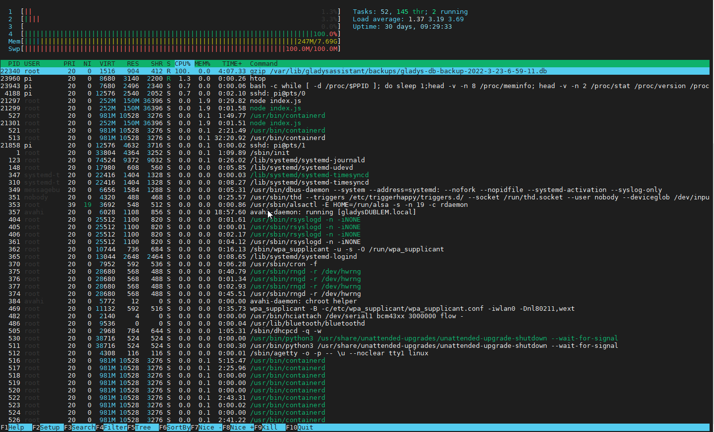

htop

Database size on Gladys Plus + backup history

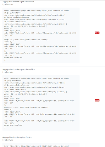

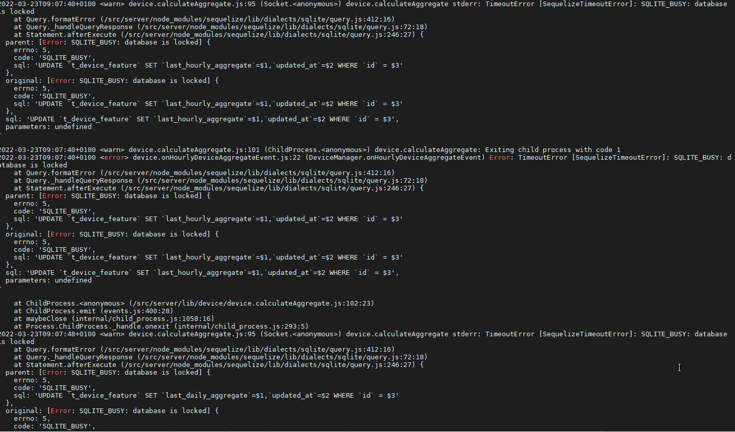

Error of tasks on DB blocked in access

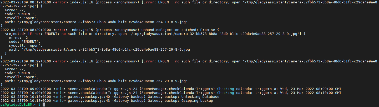

Container status

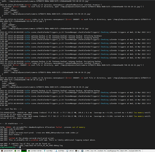

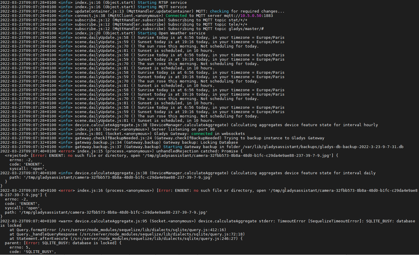

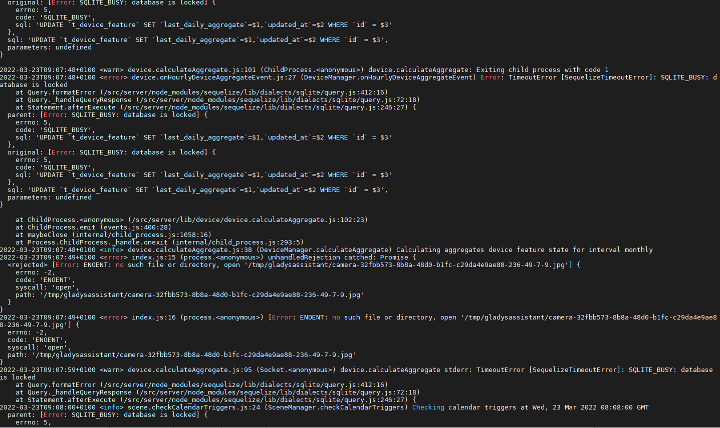

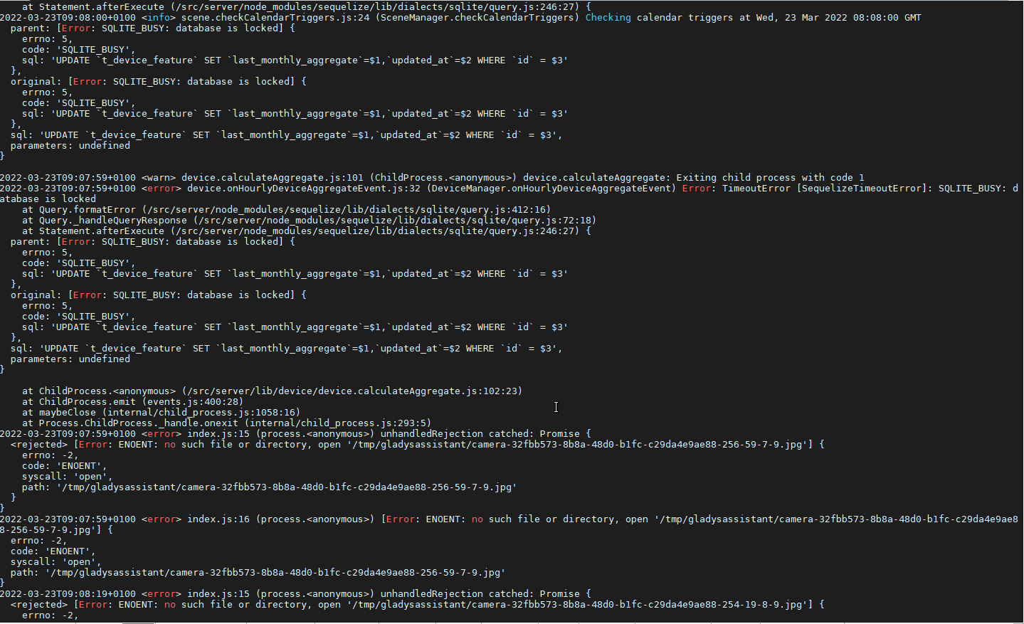

Logs before, during and after crash
I thought you had put in place things to prevent getting into database access issues during backup. Could there have been a regression on this point? Or am I wrong?

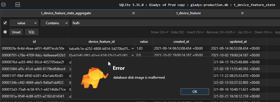

I’m currently retrieving the DB to check if there are any NaN values
Edit: No NaN values found. Just negative values, but I assume that doesn’t have any impact. However, when searching with CTRL+F (TablePlus), I get an error database disk image is malformed… Any consequences??

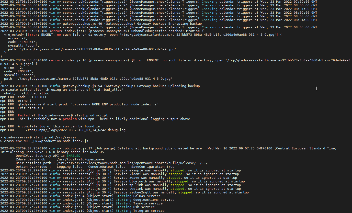

Last logs with errors:
You’re out of storage or RAM
« out of memory »
Hello @Terdious! Your gargantuan instance continues to give us challenges!! :smiley: It’s cool, it will allow us to strengthen the software even more :slight_smile:
Indeed, as the error message says at the end, backups fail due to a lack of available RAM during upload! And so they are retried regularly.
Out of curiosity, how much RAM do you have available? Can you check your RAM usage during a backup?
What is possible (to be verified, I don’t remember), is that the backup is fully loaded into RAM during the upload, which would be a problem since your backup is 800MB, if your RAM is 1GB I understand that it’s stuck! If that’s the case, the solution would be to switch to chunked upload to avoid using so much RAM. (it’s quite possible that this is the issue, I need to check how it works on the Gladys code side)

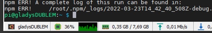

Thanks @VonOx and @pierre-gilles for your feedback.

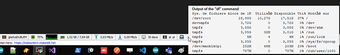

I highly doubt that the RAM is the issue. That’s why on the last screen I showed you the bottom bar: 350 MB used out of 8GB ^^
The maximum I’ve observed is 8xx MB. However, during the backup, I’m at 100% CPU usage (with peaks at 112% … :thinking:) and never releases the hand.
After a restart, the backup starts and this time regularly releases the hand to aggregation. But 30 minutes later, it’s the same story again ^^
Are you sure about the RAM? The error is quite clear, it’s an out of memory error! (350MB isn’t normal usage after the process crashes?)
Otherwise, there’s the JavaScript heap size, but on Node 14 it’s 4GB so I don’t think that’s it…
Yes, definitely sure about the RAM
For the 350MB, yes indeed it was after the crash. But on my side, visually I’ve never seen it go above 1GB, that’s for sure. I can do more visual sessions but it’s not easy to catch the peaks I suppose… And how could it possibly exceed 8GB??:sweat_smile:
Yes, it’s certain 8GB is impossible
