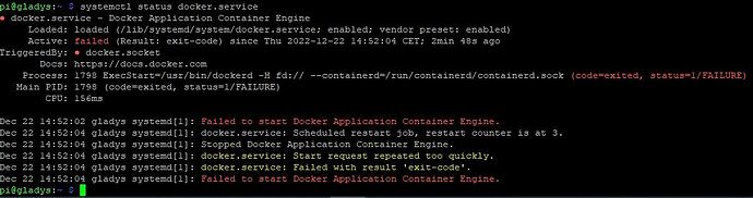

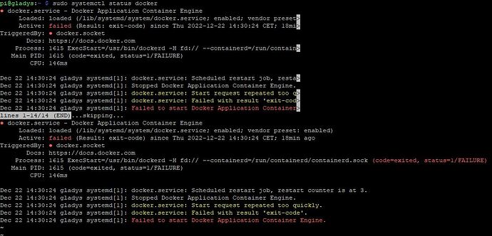

It seems that Docker is stopped.
Check its status with this command
sudo systemctl status docker
You can try restarting it manually with the command
sudo systemctl start docker
If it happens again, you should check Docker’s logs to see if there’s a problem.

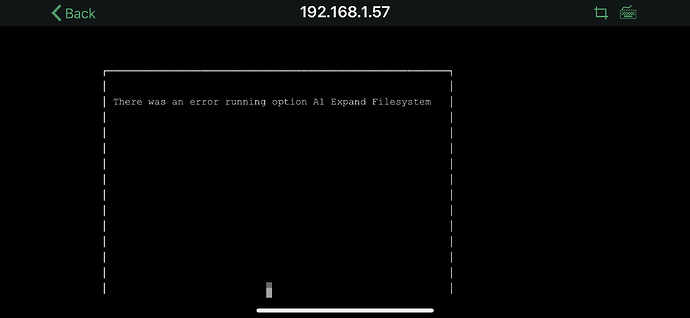

When selecting ‹ expand filesystem â€ş, I get the message
Ouch, this is getting tougher…
