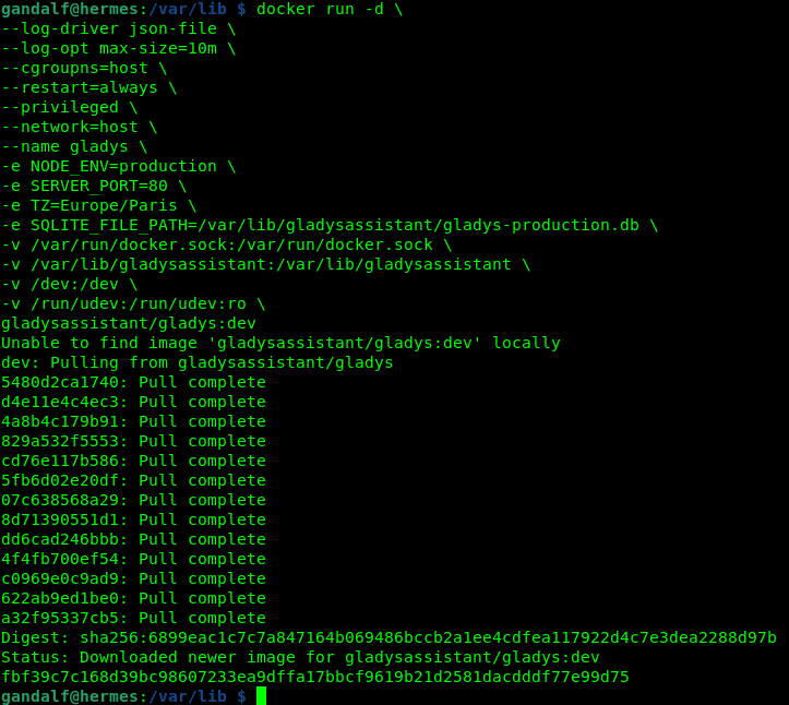

I’m testing this new container starting tomorrow. I have my Zigbee key ready and waiting, and components to test (presence sensor and temperature sensor). I’m running Bullseye 64-bit on an RPi4. I’ll keep you informed tomorrow. Thanks for this release, it’s great!
@pierre-gilles my first attempts are not conclusive.
First remark, at the beginning I modified the local directory of the volumes (/var/lib/gladysassitanttest instead of /var/lib/gladysassistant by default). The installation of the containers then posed a problem and I noticed that zigbee2mqtt had installed itself in the default directory and not the one I had given. Fortunately I had backed up my /var/lib/gladysassistant directory to not mess up my production configuration :slight_smile:
Anyway I clean the containers and start over from scratch, this time without changing the docker command you give. For this, it goes a little better, but I get stuck a little further:
I then noticed that the gladys-z2m-zigbee2mqtt container did not seem stable. It seems to restart permanently.
Moreover, I never have access to the zibee2mqtt interface on port 8080 (which seems logical).
Obviously as I am a pignouf I am on a 64-bit version of raspiOS. I have another raspi in 32 bits on bullseye with Docker and Gladys, I will try it to see if it works better.
@p6ril By any chance, have you already installed the docker dev image on this instance? I’m surprised that use case #1 doesn’t work at all for you
When you ran docker run, was there a download of the image or was the image already present locally?
You can run a docker pull gladysassistant/gladys:dev to check.
@pierre-gilles I confirm that initially I didn’t have the docker dev image. For the second attempt, I also started from scratch (I « pruned Â» the containers and deleted all the associated images, including gladys dev, and the mqtt and zigbee2mqtt containers). Both times the containers were downloaded.

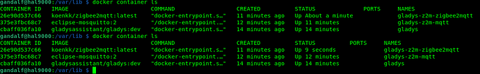

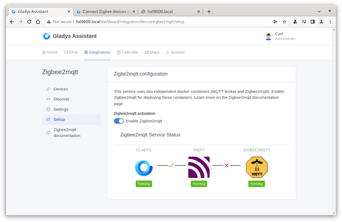

And in 64 bits where zigbee2mqtt does not start correctly:
Screenshot from 2022-03-19 11-47-16
I can help if logs or additional information about bullseye in 64 bits are needed.
Is udev installed on your 64-bit Debian?
hal9000 :smirking_face:
yes udev is installed:
Screenshot from 2022-03-19 12-47-40
The Sonoff key is well recognized, the issue seems to come from the Zibgee2MQTT container which does not start. Maybe an issue with the image on the target architecture?
You will need to check the logs of the zigbee2mqtt container
Well, I was about to do that, but it failed in the process…
I noticed that the Zigbee2MQTT container was no longer in the list returned by docker container ls.

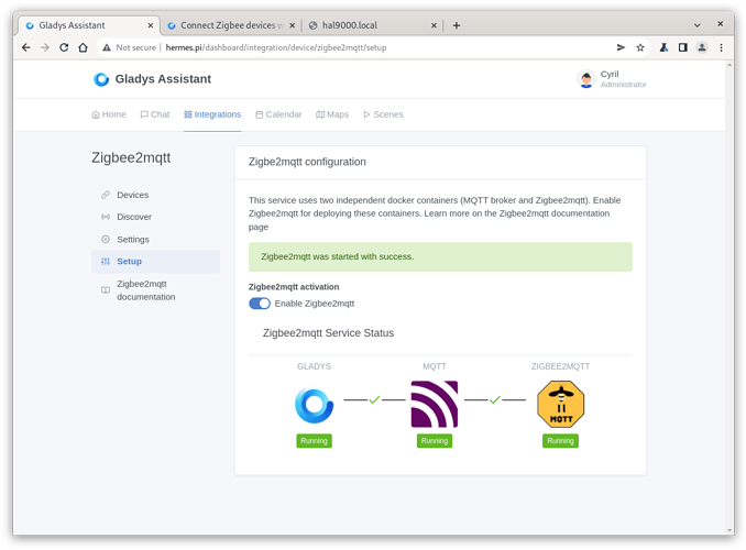

The Zigbee config was disabled (since I had removed the Zigbee Sonoff key). I put the key back, refreshed the USB dongle config, re-enabled zigbee2mqtt, and now everything seems to be in order.
All containers are up and the connection is established between Gladys, MQTT, and Zigbee2MQTT. Strange.
