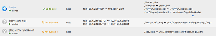

I’m back, I received my first Zigbee devices and I wanted to test them on Unraid to see if they worked correctly before publishing this to everyone and bingo, I have some beautiful bugs that are easily and not easily resolvable.
Here are my containers and the associated maps and indeed it doesn’t match.
gladys-z2m-mqtt cannot find its configuration file, same for zigbee2mqtt, in short the zigbee2mqtt module does not work directly.
For this to work, I see 2 possibilities:
  1. Change the base path /mnt/user/appdata/Gladys to the default value recommended by the installation guide which is /var/lib/gladysassistant. Problem: this is not a common practice in Unraid, plugins should rather be on appdata so we risk having difficulties in validating the plugins, and the second obstacle for me is that I’m not sure if lib is on the USB key containing the NAS OS or on the server disks and if it’s the USB key it’s really not great. (I will do a test to check)
  2. We add a variable at the start of the docker which indicates the host path containing the host path of /var/lib/gladysassistant and we correctly configure the mqtt dockers when we launch them.
    Or docker allows us to retrieve this information, I don’t know enough about it and we then use this path (which would be even better)
That’s it, I’d like your feedback!

Yes, that’s a good idea. I had the same feedback from a friend who just installed Gladys on a Synology; he has the same issue.
Edit: I’m editing my message; what I propose doesn’t work. The SQLITE_FILE_PATH comes from inside the container. I think we don’t have a choice: either we extract the path from the volume, but we have to go through the Docker API on the current container (not necessarily simple), or we add an environment variable.
@cicoub13 @AlexTrovato @VonOx This debate reminds me of something; what did we decide?
We had talked about it, as far as I remember the permanent solution is to use an environment variable as an argument for the docker run.
And it’s very easily configurable under Unraid :ok_hand:
Or is it this: https://stackoverflow.com/questions/54877755/how-can-i-find-where-is-the-docker-container-directory-in-host-machine
Couldn’t this work?
I’m not familiar enough with Docker
The issue is that you can have multiple volumes, so how do you recognize the right one?
The related discussion starts here Zigbee2mqtt : Image docker de test basée Gladys v4 - #267 par cicoub13
@VonOx I don’t understand, you perfectly found the solution, right?
In what I read, I see that you manage to retrieve the paths and the correct path is the one with container /var/lib/gladysassistant, right?
I didn’t understand why we needed a variable after that
Yes, that’s the host’s one
Gladys creates containers and the configuration of these containers (persistent files)
But from the container, we don’t know what the mount point is on the host.
Until now, we only had Linux/Mac, so in the code it’s hardcoded as /var/lib/gladysassistant
Unraid is a Linux but a bit particular…
The solution would be to indicate to Gladys container at creation, in a variable, what is the mount point on the host and use it to create the containers.
