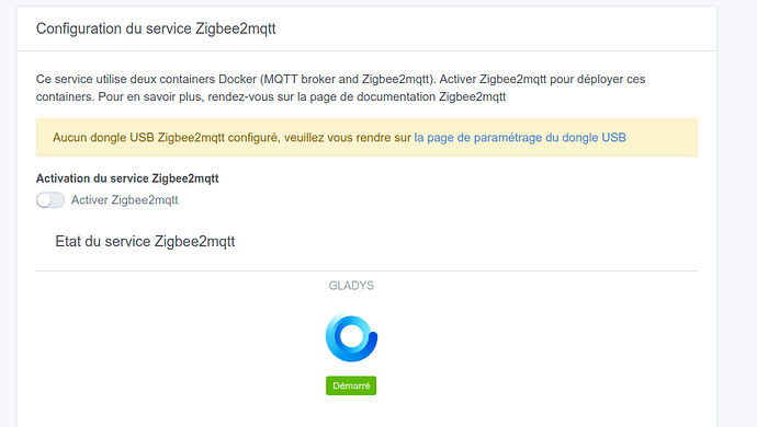

Thanks for your help,
So when I try to uncheck and recheck it it doesn’t do anything at all, I even have the impression that the button no longer works (nothing appears in the logs when I click on it), and in the integrations in the settings, both are in error and cannot be started
@pierre-gilles this could be coming from there, it reminds me of the adjustments we had to make to get it running on unraid and the addition of a variable to the docker: /var/run/docker.sock, or even this thread: Gladys sur Unraid
However, I just checked and the docker.sock is still in the same place:
