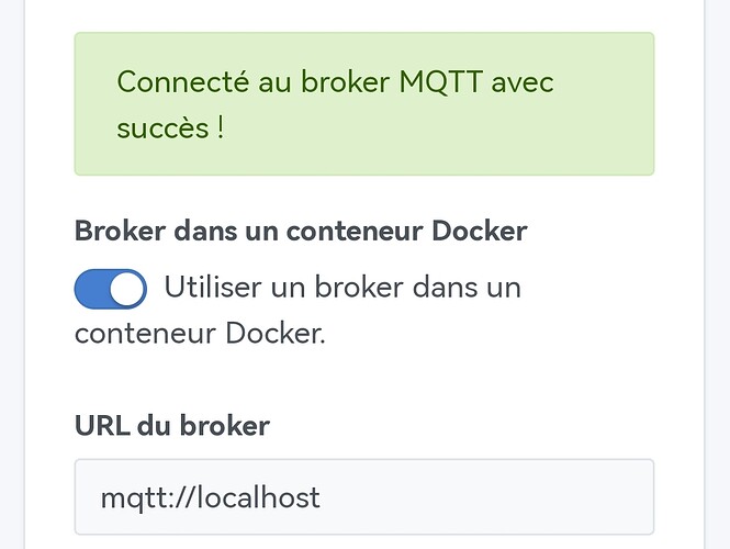

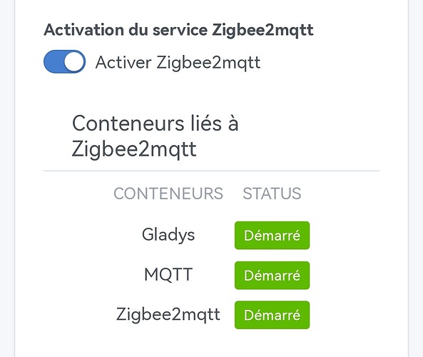

Indeed, that solved my problem, but what bothers me is that I didn’t need it before — probably Unraid hadn’t been upgraded to Debian 11. I’ll update the template that’s on git
Thanks a lot @pierre-gilles
Great, glad it works :raising_hands:
