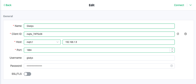

Can you connect to the MQTT server from a tool like MQTTX?
Here is an example configuration (you’ll find the password in /var/lib/gladysassistant/zigbee2mqtt/z2m/configuration.yaml)

I can’t connect to the MQTT server from the MQTTX tool.

With MQTTX I get the same connection error « Error: Connection refused: Not authorized » when I add my IP address in the 2nd host parameter. However, if I leave the config at its default with broker.emqx.io instead of the IP address it works. I don’t know if this helps you — I completely reinstalled and the same issue persists.
