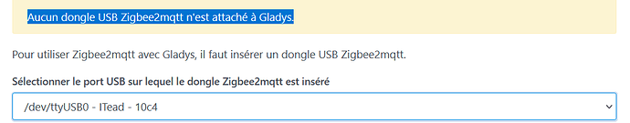

Good evening,
I have the same problem on a VM on my freebox delta.
Does anyone have any ideas?
I have a Sonoff Zigbee key
Yet Glady tells me « No USB Zigbee2mqtt dongle is attached to Gladys. »
My Zigbee key:
Thanks

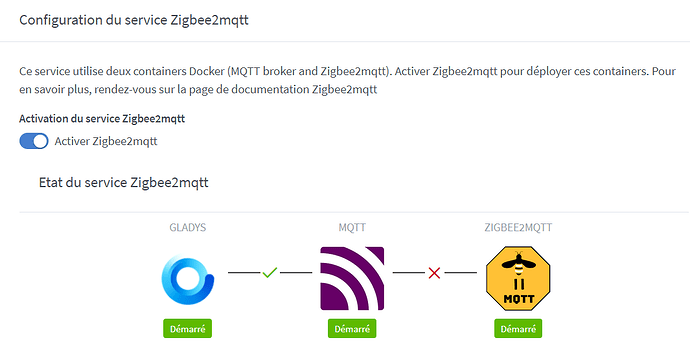

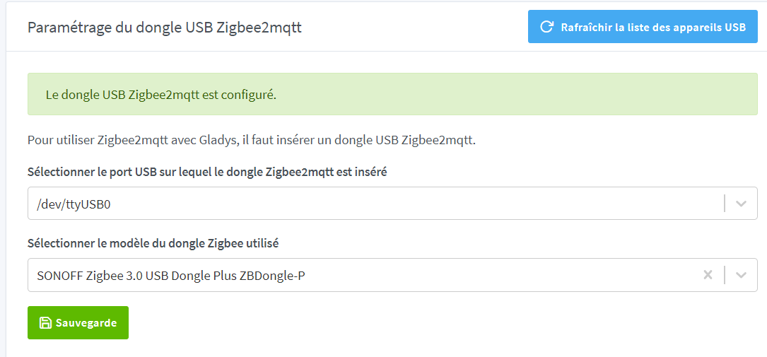

I’m just getting started with Gladys. After failing to access the USB port on my Synology NAS, I finally installed Gladys on my Freebox Delta.
I plugged the Sonoff dongle into it to use Zigbee2mqtt on a USB power strip also plugged into the mains.
So far I think I’m okay with setting up the assistant and the integration, but for discovering the Zigbee network I don’t have a « scan » button
Is there a known solution or any leads to help me, please?

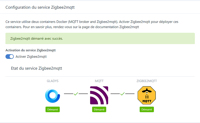

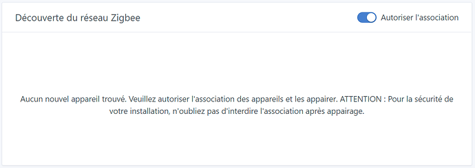

Thanks for the quick reply :smiley:
I tested with a Hue motion sensor (I chose it because I know it works well and pairs easily with the different Zigbee networks I’ve tested at home: Hue bridge and Homey).
The sensor enters pairing mode correctly (orange blinking LED) but nothing happens in the integration. I unchecked and rechecked
Hello @Alexia_Skrz :slight_smile:
There is no « scan » button on the Gladys side!
Otherwise you can connect to the Zigbee2mqtt interface directly (IP_OF_THE_PI:8080), you’ll be able to see what’s going on more easily
Correction to the documentation here fix(zigbee2mqtt): Remove Scan button by cicoub13 · Pull Request #141 · GladysAssistant/v4-website · GitHub
Thanks @cicoub13! It’s merged :slight_smile:

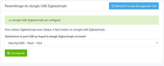

Hello, after a period of absence, I decided to install Gladys on the Freebox Delta, previously I was on a Raspberry Pi.
I tried to install zigbee2MQTT, I have a SONOFF Zigbee 3.0 USB Dongle Plus ZBDongle-P.
I tried quite a few different configurations, but nothing works.
I also followed the advice of Alexia_Skrz regarding the use of a powered USB hub, but no change.
Do you have any ideas?
Hi @camille! I’m back from vacation and I just saw your message.
Have you checked the logs of the Zigbee2mqtt container?
docker logs gladys-z2m-zigbee2mqtt
