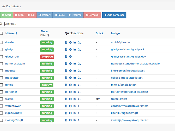

Apart from telling you that none of my containers have tags specific to the architecture
