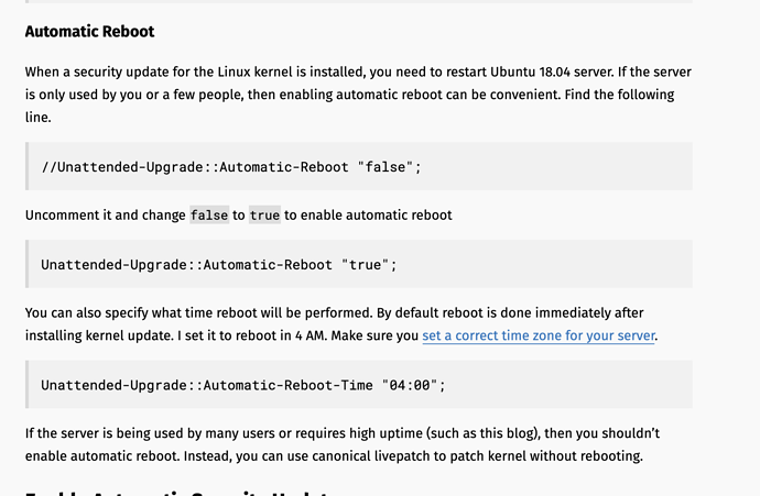

@VonOx Actually, I already use that (unattended-upgrades) on all my servers, it’s provided by default in Ubuntu 18.04, so yes it’s super stable and it does the job. We can add it to the image! :slight_smile:
Great article about its configuration →
Setting up automatic reboot at night for kernel updates can be a good idea.
Ok, I’ll do this ASAP (probably this weekend)
