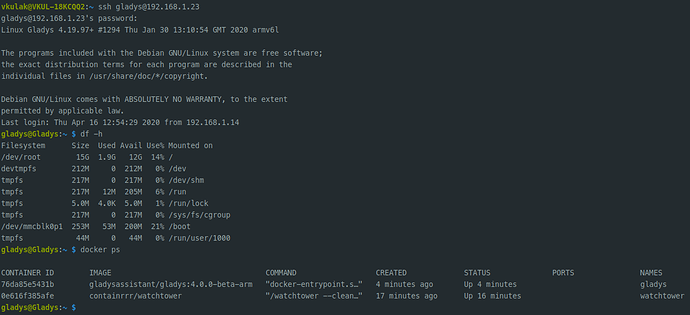

Screenshot:
The build is from today :slight_smile:
