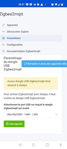

I just installed your new image V0.2.1 under bullseye.
First, my Zigbee2mqtt USB dongle is not recognized, it’s a CC2652R. I rebooted, removed it, plugged it back in… but to no avail.
The USB port is properly detected (/dev/ttyUSB0-1a86-1a86).
I don’t see where I could have made a mistake.
I tested it again with my official production image (same RPI), it works fine.
For now, I haven’t tested other integrations.
Jean Paul

For information, I’m sending you a screenshot of the Zigbee2mqtt settings page

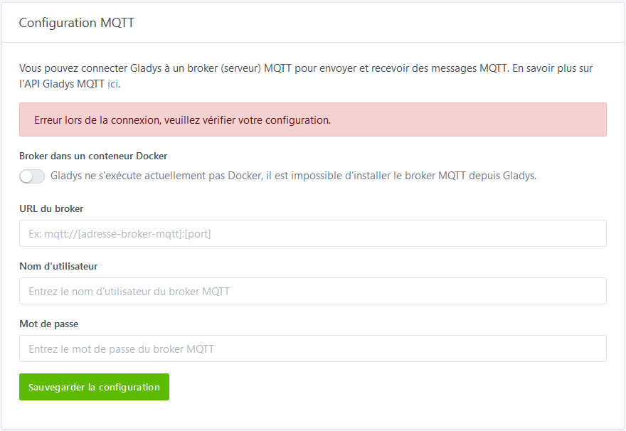

I just tested the new bullseye image. In addition to the issues encountered by @jparbel and myself (RPI4 config), it is impossible to use a USB camera
and MQTT cannot be started

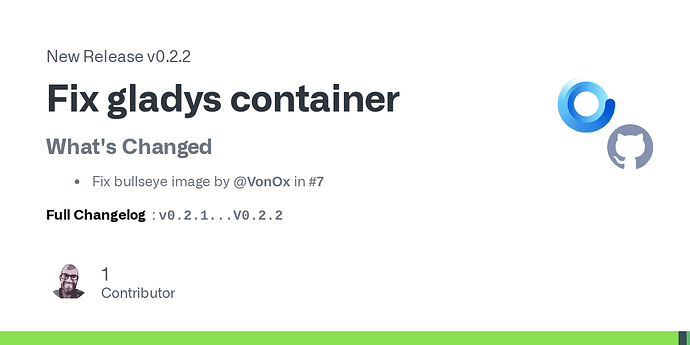

I made a new build, I think the problem is resolved but I didn’t have time to test. If anyone feels like it and has the courage.
