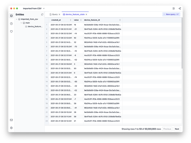

Another fairly impressive test this morning: I created a CSV of 50 million rows across 5 sensors over the last 3 years with random values.
The file is exactly 3.0 GB:
pierregilles  staff 3.0G Jun 21 10:33 output.csv
I made a small script that imports the CSV using DuckDB’s CSV import API:
CREATE TABLE device_feature_state AS
    SELECT * FROM read_csv('output.csv');
The CSV was ingested in 3.34s:
[ { Count: 50000000n } ]
start: 3.348s
The DuckDB file is 75 MB!
pierregilles  staff 75M Jun 21 10:34 imported_from_csv.duckdb
And it indeed contains the 50 million rows:
This difference is crazy :smiling_face_with_sunglasses:
