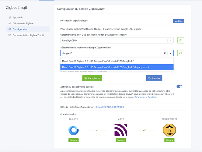

If you want to switch to Ember, it’s possible, but you’ll probably need to update the firmware of your Zigbee dongle first.
For example, for the Sonoff Dongle-E, the integration gives you the option to select the driver of your choice between « Ember » (the new default), and the old EZSP:

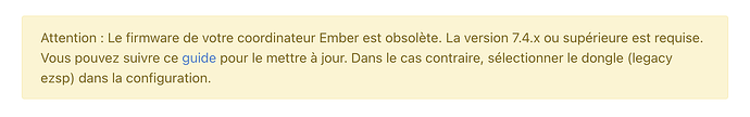

If you test the new driver and your firmware is not compatible, don’t panic, you’ll see a message:
You can then either update the firmware, or switch back to EZSP in the meantime.
