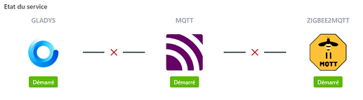

When I start the Zigbee2MQTT integration I can see my Gladys = Started - MQTT = Started - Zigbee2MQTT started, however, while the Gladys / MQTT link is OK, the MQTT / Zigbee2MQTT link does not work, I have a red cross on it.

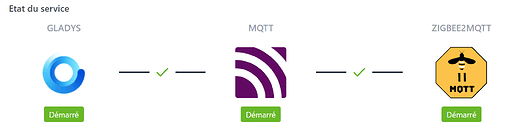

![image|690x110, 75%](upload://glfPDIsMUrp0ZHEccp
Well, that’s the downside of making several changes at the same time.. I had indeed tested the E with no result, but I think it was when my dongle was in MultiPAN. Now that it’s returned to its original configuration the E works.
Thanks… and sorry for not having double-checked that before bothering you.

same equipment and same situation for me :
(with the ZBDongle-E selected)

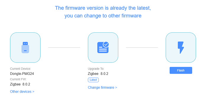

OK, very interesting question, I had flashed via the SONOFF website but I hadn’t felt like I had a choice, but actually I did:
by clicking on Change Firmware I indeed have the option
I’ll look into the multi-PAN firmware then
