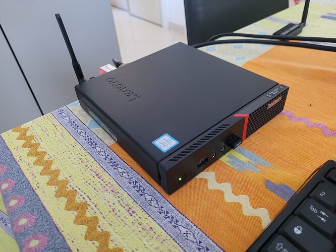

I bought a Lenovo ThinkCentre M700 mini PC on Leboncoin (4GB RAM, some i5, 250GB SSD) and a Sonoff Zigbee dongle. Very energy-efficient and not heating up, it will be installed in a closet.
