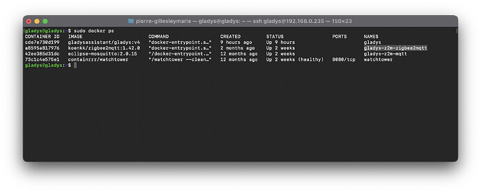

It’s my fault @bab85, I got the container name wrong.
You need to do:
sudo docker logs gladys-z2m-zigbee2mqtt
By the way, are you sure about your sudo docker ps?
On my side, I have:
