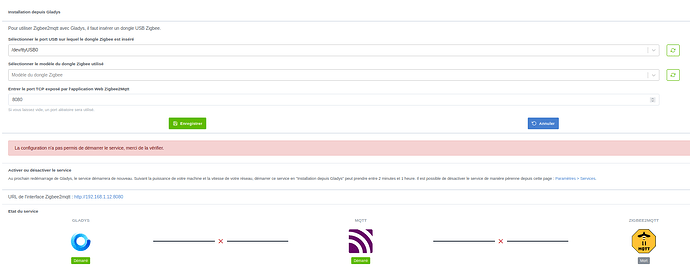

Hi, you absolutely must not do that, the configuration was fine.
This is a mapping of the path inside the Docker container that never changes.
If your USB device has changed ports, you need to change it in the Zigbee2mqtt integration on the Gladys side, but you must never touch the files on the disk :smiley:
I see that the model of the Zigbee dongle is not selected in Gladys, is that normal?
Edit: Also, I don’t understand what you’re doing with all those commands; you shouldn’t do that if you’re in an installation managed by Gladys… :sweat_smile:

Yes, I can’t find my key in the list…

I reboot and:
bc4b85e98c0e koenkk/zigbee2mqtt:2.6.1 "docker-entrypoint.s…" 30 minutes ago Up Less than a second gladys-z2m-zigbee2mqtt
it restarts every 20-30s
So there’s no point looking any further — if your key doesn’t appear, Zigbee2mqtt won’t be able to work!
You can try a few things: unplug/replug the key, restart the mini-PC (even if you’ve apparently already done so), but the key has to appear
The thing is that it’s properly detected by lsusb and that everything had been working for a while…
and if I’m not mistaken, gladys only offered the keys that it saw, right?
changing the port doesn’t change anything, lsusb still sees it but nothing particular in gladys.
