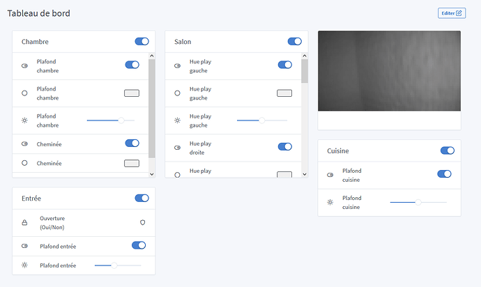

I’ve been looking without an answer so far on the forum, but do you know if there is a way to group lights? Or maybe to use the Hue zones?
I have a ceiling light with 6 Hue bulbs and I don’t see how I could turn everything on at the same time, except by turning on the room on the dashboard.
And even on the dashboard, it makes a lot of options for the same room per bulb ^^
At the same time, what is Gladys’s position on a room-by-room view?
(I intentionally enlarged the box on the home screen)

Well, it doesn’t exist yet, indeed, for now the best solution is to create a room for each « group » you want (you can create fake rooms if needed), and then turn on the room.
Another solution is to create a « fake device » by creating a device in the MQTT integration (a lamp).
Then you create a scene that when this device is turned on, you turn on the lights you want, and when the device is turned off, you turn off the lights you want :slight_smile:
Better than a room-by-room view, we aim to have multiple dashboards, to be able to separate different dashboards.
