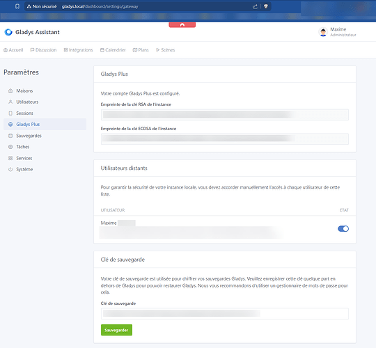

Did you manage to connect locally from Gladys to Gladys Plus? ![]()
To see if it wasn’t related to Google Home, I cleared the app’s cache and did another pairing that worked perfectly.
