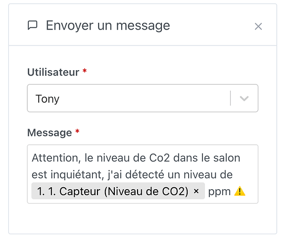

I’m working on a much-requested feature that I think will be useful to many people: the ability to inject a variable into scenes!
Here’s a sneak peek of the feature:

Hi @cicoub13 @VonOx @atrovato, I would love a review from you on this PR!
Th… is is how it looks like:
https://user-images.githubusercontent.com/7365207/104939530-d229c100-59b0-11eb-93e1-87bf4c4bcfe1.mp4
Is the shortcut straightforward? (having to type " {{ " to open the variable list ?) Should we use another trigger ? Like "#" ?
This feature will be extended to basically all input field in scenes, for exemple in the HTTP request it could be super useful to automatically inject a variable into a POST body :)

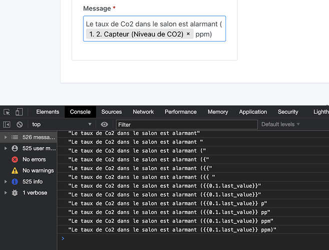

Hello. I took a look at the PR and there is an initialization error with tagify
Uncaught (in promise) TypeError: _this.props.action.text is undefined
initTagify SendMessageParams.jsx:102
refreshVariables SendMessageParams.jsx:78
promise callback*SendMessageParams/_this.refreshVariables/< SendMessageParams.jsx:76
refreshVariables SendMessageParams.jsx:49
componentWillReceiveProps SendMessageParams.jsx:138
I tried in every way, with different devices or actions in the previous groups
Oh bother! Thanks for the feedback. I’ll let you know when it’s fixed
@cicoub13 normally it’s good I pushed a fix!
Let me know if you see other bugs. Don’t hesitate to brutalize the feature, it needs to be robust!

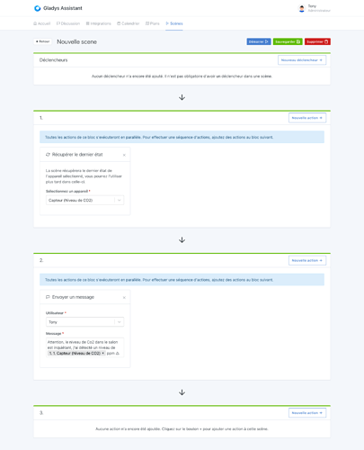

Does it only work for sensors?
Well, maybe it’s not clear, but you must have a box that sets a variable to use variables!
Good point
Here’s an example of a scene:
Any ideas on how to make this clearer?

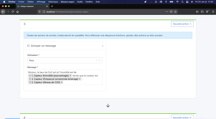

Oh yes it works better ^^
Small glitch on FF
I think we need to indicate (when nothing pops up ^^) that you first need to retrieve the device value.
Because I must admit it wasn’t clear (even if it’s logical in the end).

Everything works on Firefox at my place, I think it’s a problem because your box is too long!
Edit: it’s indeed a text size issue.
We could even make the box bigger to allow larger variables to fit:
