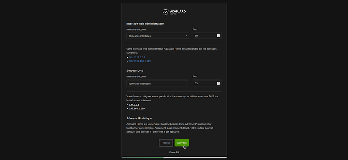

Another important point: when first launched, the AdGuard configuration assistant (on port 3000) asks you on which port to place the administration interface, and it proposes 80 by default. Choose 3000: the interface will thus remain on http://ip:3000 and will not interfere with Gladys.

When you arrived on this page, if you chose port 80 for the web administration interface, it won’t work (as it’s already used by Gladys). You can choose a different port like 81

No no you can just delete the adguardhome container (as you did earlier) and the configuration in `/opt/adguardhome/conf’
You then restart adguardhome and it will offer you the configuration assistant again (make sure to choose port 81).
Port 81 doesn’t seem like a good idea either… same result. I’m quite tired, I’ll let a good night’s sleep pass, and try again tomorrow with other ports. Thanks for your patient help.
