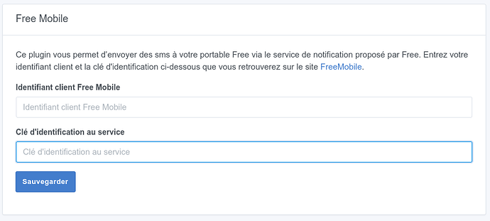

To practice coding, I implemented the SMS integration with Free Mobile
And the addition of a new action Send an SMS in the scenes
It works for me. Here is an image for those who use Free Mobile and want to test:
willde71/gladys-test:free-mobile-sms

@_Will_71 I just tested your development, it’s great!!
I had no issues using it, with scenes, whether passing variables or not.
Nice work :blush:
The only thing I would mention is to make the « Service identification key » field a password type, I think.
Thanks for the feedback.
For the key, I based it on the other integrations and they are not of the password type either.
But I can change it.
The only issue with switching to a « password » field is that the autocompletes then replace the data in it automatically with your Gladys password
Firefox is actually the worst about this — it doesn’t respect « autocomplete=off », so you have to use some pretty dirty hacks to stop it from putting the password everywhere ^^
So yeah, it’s good to set it as a password, but if it’s done poorly it creates more problems than it solves ^^

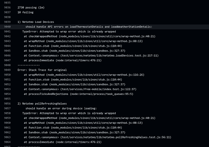

@pierre-gilles, I need your help because I don’t understand.
I made corrections and I still have errors and the server tests are not passing.
But this time here’s what I get directly on GitHub:
The integration tests OK
Coverage is OK
Screenshot of 2024-11-11 22-47-46
But there are 10 errors related to NetAtmo
There is surely something but I don’t see it. If you could point me in the right direction. Thanks in advance.
@Terdious already had these issues with the Netatmo integration?
I don’t think this is coming from the Netatmo integration because I noticed that in each error there is a line related to my test file.
Greetings to both of you!
So no but yes ^^ as I recall I had big headaches with resets and timeouts in the tests. But I don’t remember if it was on this part.
Maybe @_Will_71 uses it the same way and that impacts the other… or I was the one who did it wrong… I admit that I can’t say for sure like this.

@_Will_71 I rebased your branch, and I tested locally, I didn’t have the issue, we’ll see what it looks like on the CI :slight_smile:
Edit: Ok the error is still there
Ok I think I know what it is, the two integrations set up the same stub and so it conflicts. You need to create a sandbox to prevent it from polluting other tests:
Example:
const sinon = require('sinon');
let sandbox;
beforeEach(() => {
    sandbox = sinon.createSandbox();
afterEach(() => {
    sandbox.restore();
it('should test something', () => {
    const stub = sandbox.stub(SomeObject, 'someMethod');
    // Test code...
@_Will_71 all good, I
