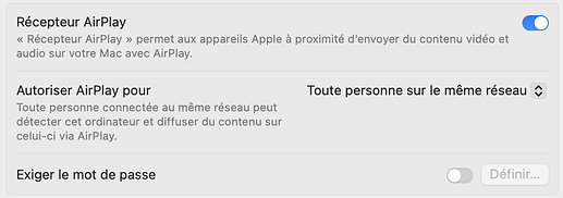

Normally it works on Mac too. However, there are some additional security measures: you need to allow AirPlay connections from devices on the network (by default it’s only connections from the same account) and make sure there isn’t a password set. Also, a notification appears in the top right when Gladys wants to broadcast to the speakers — you have to accept it manually.
Note that on HomePod not all of these security measures are present
Indeed, that was it — if I switch to « everyone on the same network », it works fine! Great job!
