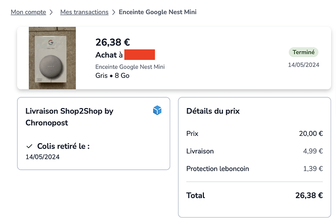

Whether you use Google or not, these connected speakers offer excellent value for money (probably sold by Google at zero margin or even at a loss), and can be found brand new on leboncoin from 20€.
I bought one last week myself for this experiment:

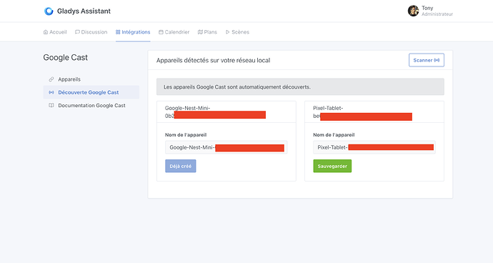

I quickly created a small integration in Gladys:

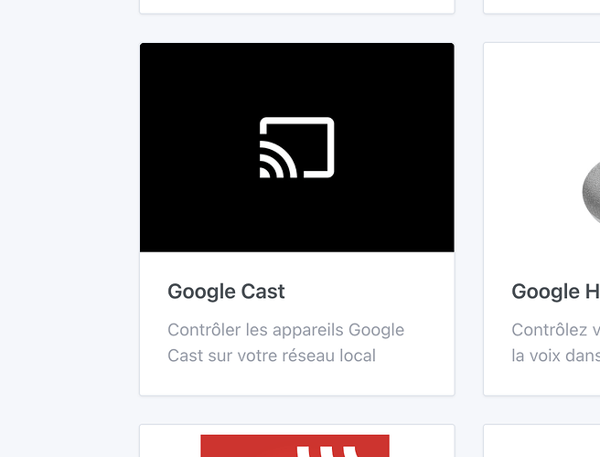

The same scan tab copied and pasted on Sonos:

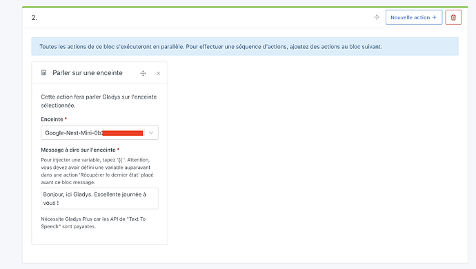

Can be used in scenes with the action that already exists!
And there you go — it works:

I tested the image and I can scan my Google Home Mini and my Google Nest Hub (I imagine it also works with a Nest Hub?).
However, I see very few logs related to the Google Cast integration, is that normal? (I see device removal compared to LAN manager or Sonos where you can clearly see when a scan starts and when devices are found.)
I would have liked to test the rest: speaking on the speaker via scenes but that requires Gladys Plus which I don’t have on my test instance. I would consider testing with my production database to have Gladys Plus but I think that’s not recommended.. what should I do?
@qleg Thanks for testing the network discovery!
There might be slightly fewer logs than for other integrations
For the TTS, if needed I can give you a Gladys Plus test account! I’ll send that to you in a PM :slight_smile:
Thank you for the GladysPlus account, I confirm it’s working :slight_smile:
