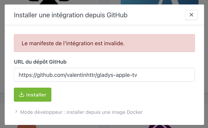

I tested and got this error:

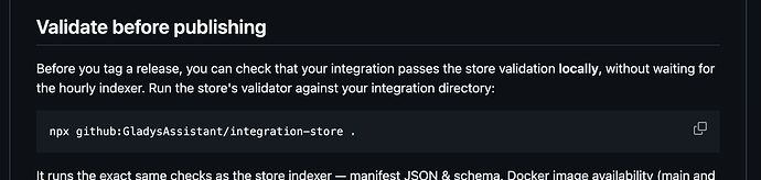

Codex might be less strict than Claude aha, but Claude always thinks to run the validator before publishing:
The command:
npx github:GladysAssistant/integration-store .
Oh! I’ll look at that a bit later… it’s strange because I did an installation last night and it was working :o
The error is:
    "status": 422,
    "code": "UNPROCESSABLE_ENTITY",
    "properties": "actions[1].depends_on: unknown field ; actions[2].depends_on: unknown field"
I’ll add the error to the interface so it’s easier to debug :slight_smile:
New release available, try again and let me know if something needs fixing :slight_smile:

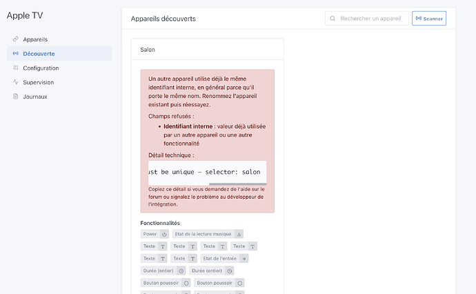

We’re making progress, but this time I have another error:
The selector could be a bit more unique than that ^^
Codex still has some work to do :joy:
I may have been a bit « cheap » with the reasoning used haha
But it’s true that he didn’t bother for this one :joy:
New release available, I asked him to self-review and fix other potential issues of the same style!
Don’t hesitate to let me know if you encounter other issues if needed

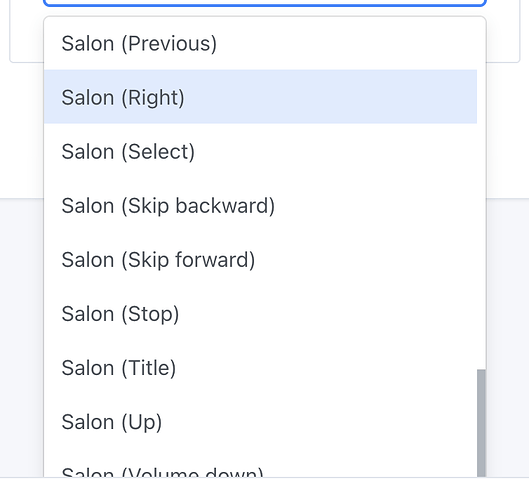

I was able to add the Apple TV this time :slight_smile:
However, the device name could contain « Apple TV », because right now it’s just the room name (it must be the name given by Apple to my Apple TV), and so it’s not very readable:

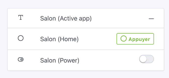

Otherwise, I tried turning on the Apple TV with the « Power » type, but it does nothing:
The logs show nothing special:
[2026-08-03T15:22:33.784Z] [INFO] [apple-tv] Starting the Gladys Apple TV integration
[2026-08-03T15:22:33.982Z] [INFO] [gladys-sdk] connected to Gladys (http://172.30.0.1:80)
[2026-08-03T15:22:39.142Z] [INFO] [apple-tv] Starting mediated Apple TV discovery
[2026-08-03T15:22:48.502Z] [INFO] [apple-tv] Discovery completed: 1 Apple TV device(s) from 1 candidate host(s)
[2026-08-03T15:24:50.959Z] [WARN] [apple-tv] Apple TV real-time updates unavailable for Salon: Got pyatv Error: power_state is not supported; using polling
[2026-08-03T15:24:55.556Z] [WARN] [apple-tv] Apple TV real-time updates unavailable for Salon: Got pyatv Error: power_state is not supported; using polling
Does it work for you?

I’m looking to fix it, but yes, Power was working for me last night.
