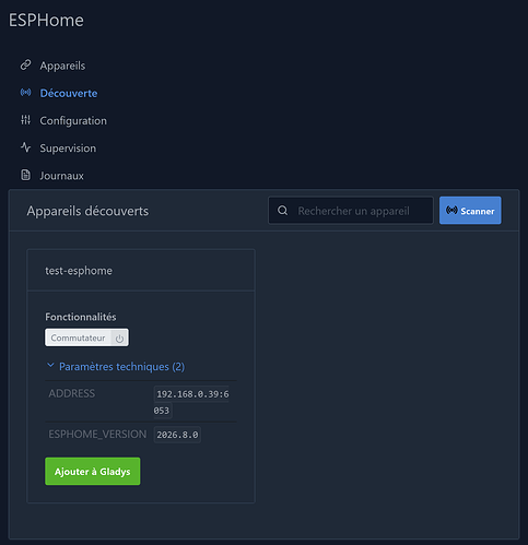

I was finally able to test the ESPHome integration
Since you indicated you weren’t equipped to test it, I used a small NodeMCU v2 ESP8266.
I installed ESPHome Device Builder, created a first device test-esphome with the standard configuration:
esphome:
  friendly_name: test-esphome
esp8266:
  board: nodemcuv2
logger:
api:
  encryption:
    key: "..."
ota:
  - platform: esphome
wifi:
  ssid: !secret wifi_ssid
  password: !secret wifi_password
  ap:
    ssid: test-esphome Fallback Hotspot
    password: "..."
captive_portal:
I flashed the ESP via USB from ESPHome Device Builder.
It connects correctly to Wi-Fi and gets:
IP Address: 192.168.0.39
Hostname: test-esphome
Signal strength: -49 dBm
My Gladys is at 192.168.0.36.
And then, after entering the config in the ESP Home integration, nothing is found during the scan.
I even tried later to manually add the node in the configuration:
192.168.0.39:6053
Other info, the ESP logs clearly show that Gladys is able to connect to its API:
Accept 192.168.0.36
esphome-client (192.168.0.36): connected
So the network and port 6053 seem OK.
On the other hand, then it gets quite strange:
Accept 192.168.0.36
Accept 192.168.0.36
Max connections (4), rejecting 192.168.0.36
Then several:
Reading failed CONNECTION_CLOSED errno=11
The ESP indicates:
API:
  Address: test-esphome.local:6053
  Max connections: 4
  Noise encryption: YES
The final result on the Gladys side remains:
No device discovered yet.
While the ESP clearly sees Gladys connecting.
I don’t know if we can draw any conclusions…

Hi @b3n.0
Your feedback was extremely helpful — it contained exactly the right clues. I found the problem, and it wasn’t your hardware, your config, or your encryption key. Your installation was good from the start.
What was happening
Your test-esphome YAML doesn’t declare any entity: api, ota, wifi, logger, and that’s it. It’s the default YAML of ESPHome Device Builder, nothing to blame you for.
But my code was simply discarding any node that didn’t expose any usable functionality. The connection was successful — that’s what your ESP logs showed (esphome-client (192.168.0.36): connected), the encrypted handshake passed without issue — but the node was discarded right after, in silence. Result on Gladys side: « No device discovered Â», indistinguishable from a bad key or an unreachable ESP.
That’s also why manually adding 192.168.0.39:6053 didn’t change anything: the problem was downstream of the connection, not at the network discovery level.
The Max connections (4)
Your second symptom was a distinct bug, which your log helped identify. The client library I use retries a connection 3 times by default, i.e., 1 attempt + 3 retries = 4 sockets. And the ESPHome firmware accepts… exactly 4 API clients. A single failed scan thus saturated your ESP’s entire quota, hence the rejecting and then the CONNECTION_CLOSED errno=11. I reduced this to 1 retry (2 sockets max), which leaves room for the node while absorbing an ESP in the process of restarting.
Fixed
  1. A reachable node is now always reported in Gladys, even without any entity. It will appear without functionality, but it will appear — you’ll know that the connection works.
  2. No more saturation of the ESP’s connections.
  3. The log has become explicit and directly gives the steps to follow:
ESPHome node « test-esphome Â» (192.168.0.39:6053) is reachable but exposes no feature
Gladys can use (0 entity(ies) seen): declare an entity (switch, sensor…) in its YAML
I added a regression test that reproduces your specific case, and I verified that it failed on the old code — so that this scenario can’t slip through again.
For your next test
While waiting for the new image, you can already validate the complete path by adding an entity to your YAML. The simplest, and it’s perfect since it’s your cat feeder project:
switch:
  - platform: gpio
    pin: D1
You reflash, and the switch should appear directly in Gladys. That’s the feedback I’m most interested in now: knowing if the on/off command really works on real hardware. I always develop without an ESP at hand, so your tests are what’s moving this integration forward.
I’ll let you know as soon as the dev image is published.
The dev image is ready, you just need to force the update from Gladys.
Top! I quickly added a switch to my first test (no physical connection yet) and:
I’ll work on the relay/motor connection and come back for a debrief…
