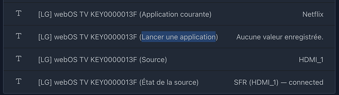

Today we don’t have a select type
I was thinking of an input that would list the applications installed on the TV or the TV sources.
This means I can’t create a « Launch an application » or « Source selection »
Today:

3. The select
You’re right, and this is the most interesting point of the three. There is indeed a mechanism for device options (supported_options), but it is designed for closed enumerations defined by the core: the values are integers and the labels come from Gladys’ translated catalog (air conditioning modes, fan speeds…). The integration only restricts a list that the taxonomy already knows.
A list of TV applications is the opposite: open, specific to each device, identified by strings (netflix, com.webos.app.hdmi1), and changes when the user installs an app. Above all, don’t map them to integers: you would have to maintain an index ↔ appId correspondence that will change with each rescan, and the scene « launch app 3 » would silently launch something else the next day. It’s the kind of bug that’s impossible to diagnose.
Therefore, a real « select with string values » is missing, with options published by the integration. It’s a generic gap, not specific to LG (TV sources and apps, favorites and playlists, vacuum cleaner parts…), so I want to design it properly rather than hack it together.
Will you create a feature request for this topic?

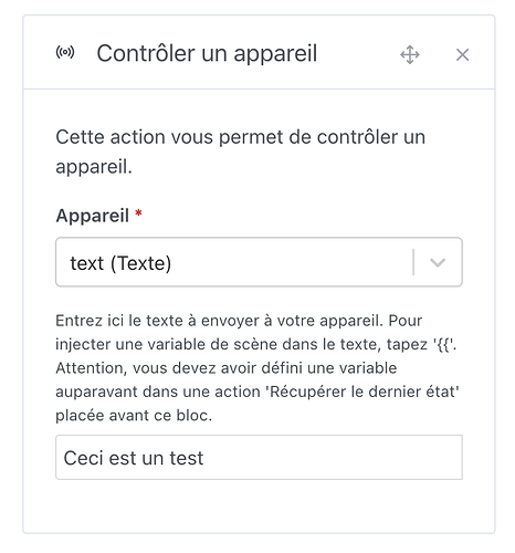

  2. TV notifications
    I’m not sure about this one, I did create a text-type feature
name: ‹ TV Message ›,
external_id: ids.feature(FEATURE_KEYS.TOAST),
category: ‹ text ›,
type: ‹ text ›,
min: 0,
max: 0,
read_only: false,
has_feedback: false,
keep_history: false,
But when I perform a ‹ control a device › action, I have no action that triggers with text, except if I send an int
In the repo I see this:
I see that only int can be set and not strings.
I must therefore not be on the right action.

I thought the usage was the opposite, that you wanted to see in Gladys information coming from the TV.
So, you want to basically send a text notification to your TV? Is that right?
Well if that’s the case, I think I’ll install this integration and test what will be possible :grinning_face:
I can confirm that :slight_smile:
I’m already doing it via a test
But I think I’m missing the feature
Indeed, in this case we currently don’t have the possibility to do that! :slight_smile:
I’d be happy if you could create a request!
fait : Action de scène : Envoyer un message sur un appareil
We therefore have 3 features on the agenda:
@spenceur What I’ve done so far for notifications is that I’ve added the management of « text » type devices on the « Control a device » action:
The PR, merged:
I think this will be useful to a lot of people :slight_smile:
