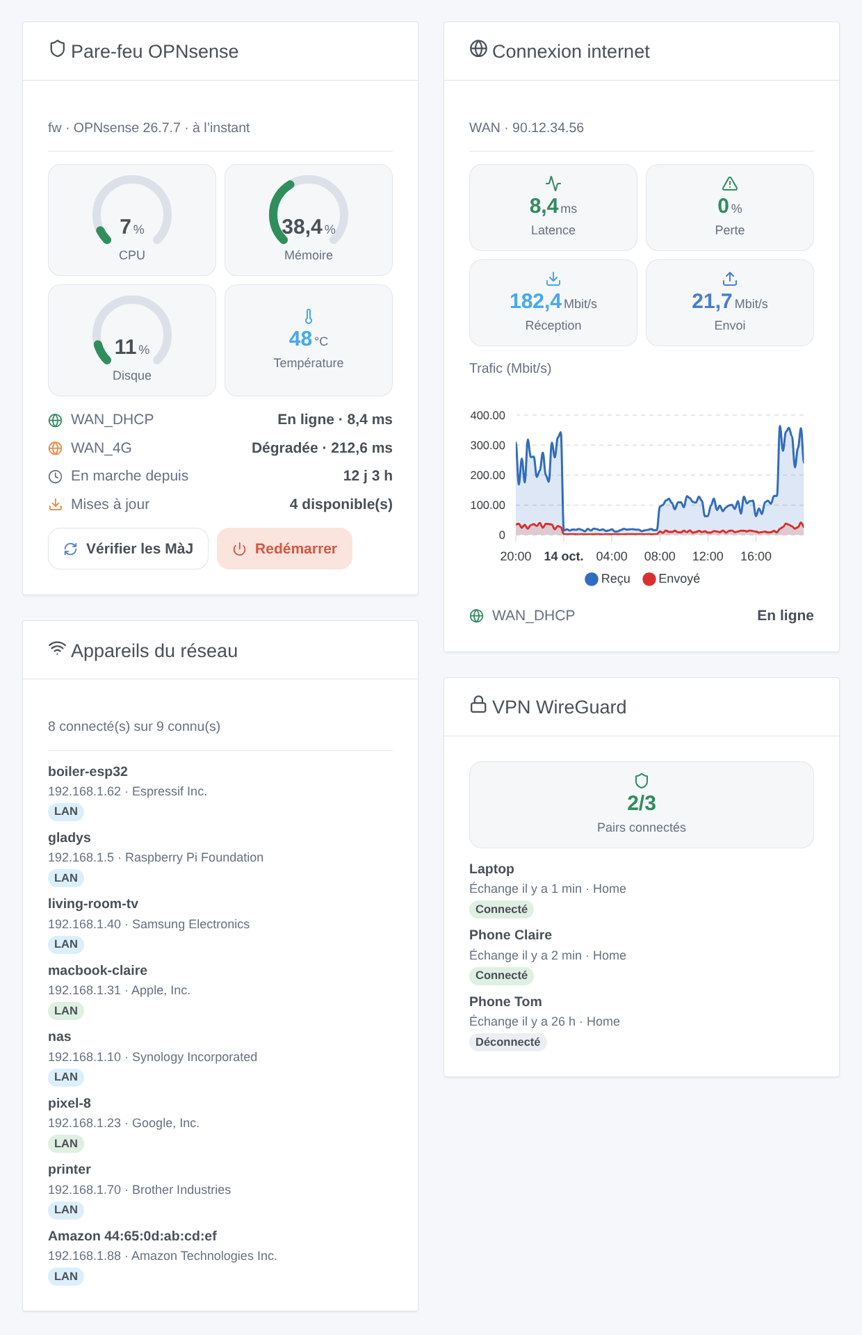

The four widgets, illustration generated from the code on fictional data, not a screenshot
