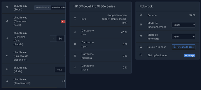

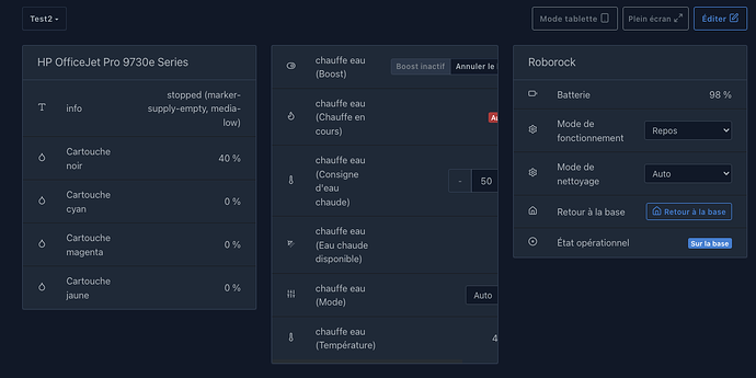

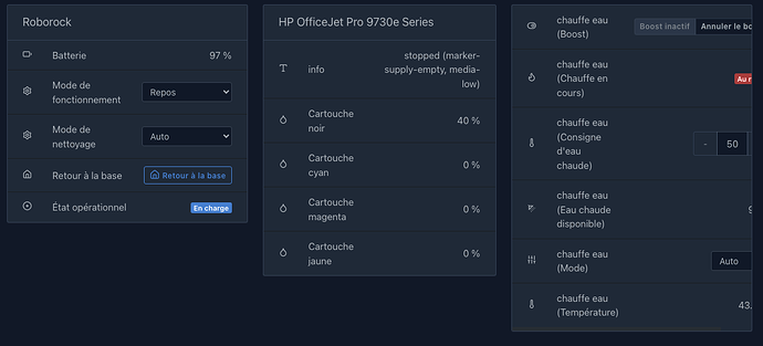

First feedback (but I think the issue is more on Gladys @pierre-gilles)
Indeed, when we set it to 3 columns, I have the same problem:

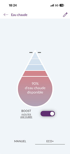

I think we can’t do it via the application but potentially we could on certain water heaters (maybe the feature is just not enabled to prevent people from going too low :thinking:)

To know that when you launch the away mode via the application we have this:
When I click on auto I switch to Eco+
When I click on manual I switch to manual
When I click on Eco I stay in manual

  • For the inverted Boost buttons, it seems to be a bug in Gladys. I opened an issue here Dashboard binary buttons show the action for the current value instead of the one they apply · Issue #2810 · GladysAssistant/Gladys · GitHub
  • For the adjustable setpoint temperature via Gladys but not in the app, it’s the same behavior as HA. Indeed, in the application, it is not offered because it is managed via the mode.
  • The away mode has been fixed but we are not at the same level of configuration as in the application. You need to trigger the away mode, then remove it when you want (I imagine it’s possible via a scene).
  • The heating state return should be fixed.
  • The Eco mode should be fixed.
  • I’m looking into the buttons that are sticking out :eyes:

Do you mean the heating status (in the app)?
Yes, you activate it with the bars that go up (I don’t know if you understand :sweat_smile:)
