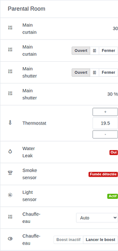

Issue created: Display issue with 3-column layouts · Issue #2877 · GladysAssistant/Gladys · GitHub

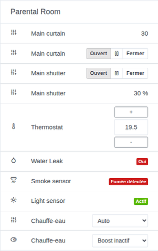

Before/After
Bug fixed and PR opened: Fix water heater boost control overflowing narrow dashboard cards by Pierre-Gilles · Pull Request #2878 · GladysAssistant/Gladys · GitHub
